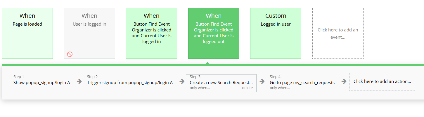

I tried this, and after sign up I add action, but pass immediately so we don’t wait when user login/signup or if I set ‘only when user is logined’ it never happens.

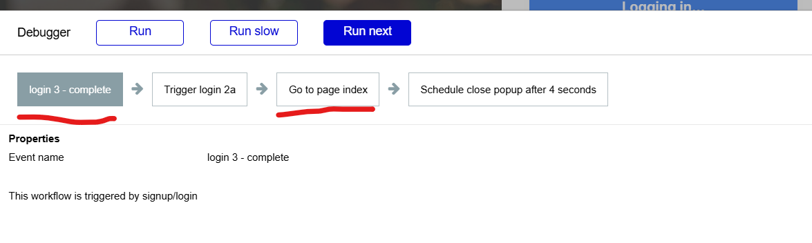

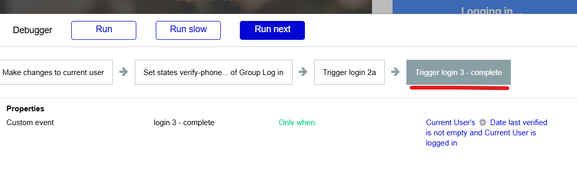

Now it more clear for me. 1. after user loggined the component call ‘login 3 complete’ event. 2. the ‘login 3 complete’ event has redirect to index and close popup.
so I think if I can just add ‘condition’ to go to index it will save my flow?
yes, you’re correct @prosto.duda you can add a condition to prevent go to index page if the current page name is not login. or any expression you see fit.

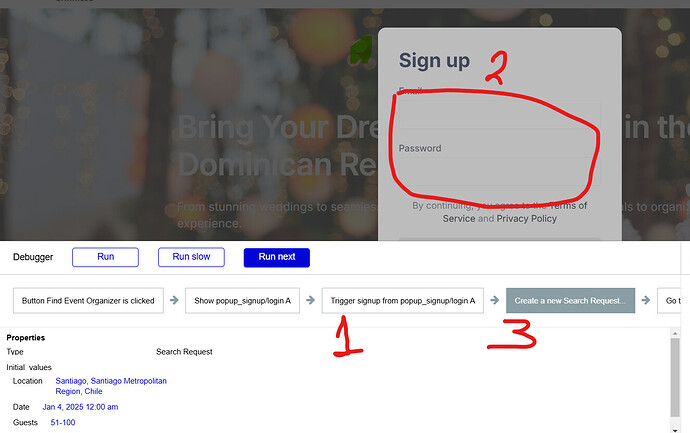

Thanks for spending time on me. This screen shows how popup appear, but after this, immediately fire the next event to create a record, but we are not login yet.

Create 2 event when the user clicks on sumbit:
  1. event when user clicks on submit & current user is logged in - here you would just create and redirect.
  2. event when user clicks on submit & current user is not logged in -
    a. Create different state on the signup/login component (each state would take the form input value) - that would transfer those values inside the signup/login flow
    b. ensure that the submit button is unclickable unless the user fills all the form completely
    c. when the login flow is complete, check (still inside the signup/login component) if all those values are not empty, if not, then trigger a custom event inside the signup/login component (create a custom event that has 2 actions. i.) creates the record from the signup/login component states and ii.) redirects the user. )
This should solve it for you.
