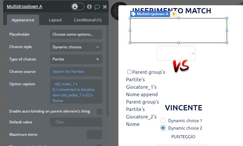

I need a suggestion to use two variables from custom state in a dropdown section. If I insert them one after the other it gives me a single string (like append function)… thanks

thanks, I saved two values in custom state, two names coming from the usual table in the db (same row)
I would like to use these two values as the choice for dropdown or dynamic choice
Are you referencing your custom state in Choice source? It seems you are doing a DB search instead.
Maybe that’s where I’m going wrong
I have two values, two custom state variables called “G1” and “G2”
I need to be able to fit them into dropdown or dynamic choice
how can I do?
In Choice source you need to construct an expression A's B where:
A = the element you’ve created your custom state within
B = your custom states name
For example, if you’ve created custom state “Users” at index page level: index's Users

ok but I have to enter two choices in the dropdown menu
or in the dynamic choice
be able to choose one of the two variables G1 or G2
G1:converted to list:plus item G2
If you mean selecting multiple options in the dropdown - that’s not possible, you need to install multidropdown element.
also in this way it fits the values into a single choice
bbb
This should be the option source (if you want the drop-down to have two options - G1 and G2)
sorry but i cannot fiund G1 and G2 in choice source
It should be old_index1’s G1 based off of your previous screenshot
Ah, now I understand what’s going on. I missed that you are using 2 custom states with a single value inside each of them (not 1 custom state with 2 values in it).
Then, yes, what George proposed should work.
SOLVED; perfect tanks :wink:
