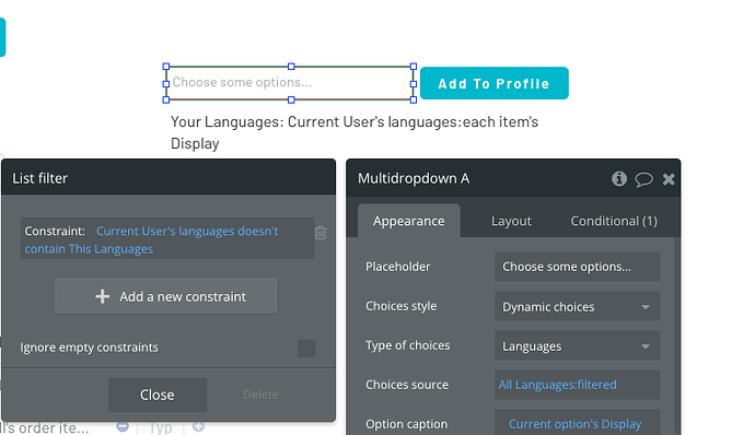

Adam is absolutely right. Option sets would be the best fit for this sort of thing. Also you should be using set list to update the field. There are two things you need to do to avoid duplicates:
  1. Make sure the multidropdown only shows options the user hasn’t added before:
  2. Since users can add items one by one or many at a time, everytime the button is clicked, the current value should be added to the user’s existing items, not replace them:
check it out;
