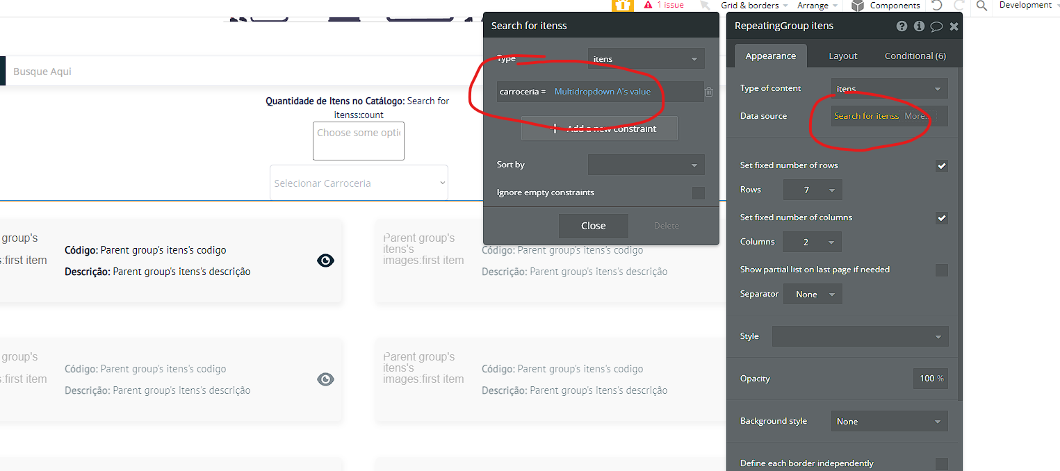

Here is my repeating group and my logic of search

When i try to solve this error, I choice this:
But isnt work when i try to apply multiple of “carroceria” in Multidropdown
Is the dropdown showing unique elements now? I thought that was the issue you were trying to solve.
Yes, but now he can’t search with multiple choices, only with one
In the constraint on the repeating group’s data source, try changing = to is in.
YEAAH!! Its work! Thanks a lot
