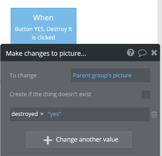

I’m using the change thing command because I don’t really delete the thing, just hide it by only showing things that destroy’s value is “no”.
I created a destroy value that is set to “yes” when user clicks ‘Yes Delete It’.
This is my current workflow but it doesn’t change the value of the thing:

That would be the way, you can have a “collapsible when hidden” group in the cell. The repeating group cell should expand to include the confirmation box, and the shrink when you hide it again.
Alternatively, set a custom state on the repeating group of “thing to be deleted” and reference that in the popup.
