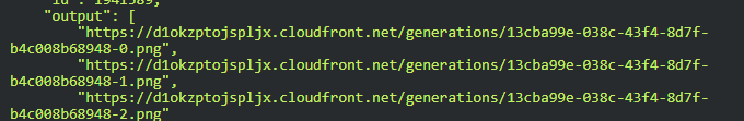

I am making an API call, and it successfully goes through and returns data.
How do I use this data?
In my instance, it is returns image URL’s and I want to show these image URL’s on my page, but don’t know how to access the returned data to show these images in an element.

Yes, I’m making the call from the frontend.
Once the call is made, is returns these images, I am doing this in Bubble edit mode.
But, how do I gets these links to show up as images on my frontend?
I tried doing the Result of step1 – yet no option to set anything as custom state.
You would do the “Set state of an element” action after your API call, pick an element and make a new custom state (text, list). Then what options does it give you after Result of step
? It should have output
Okay, I set the element state and set the after step 1 to output.
However, not sure where to go from here, no option in the dropdown get that link to show up as the image.

This is what I thought too,
but under data source, I don’t find anything to trigger the output of the API that I need
