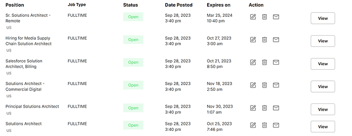

I have a problem that I’ve been trying to fix since yesterday. I have a repeating group full of job posts. I want to update the expiry date of all jobs posts all at once whenever a page is loaded. I would really appreciate some help. I have attached pictures below to help in better understanding.
On the screenshot above, I have a list of jobs. I need help on how to update the dates on the “Expires on” column for each job to the database whenever the page loads.

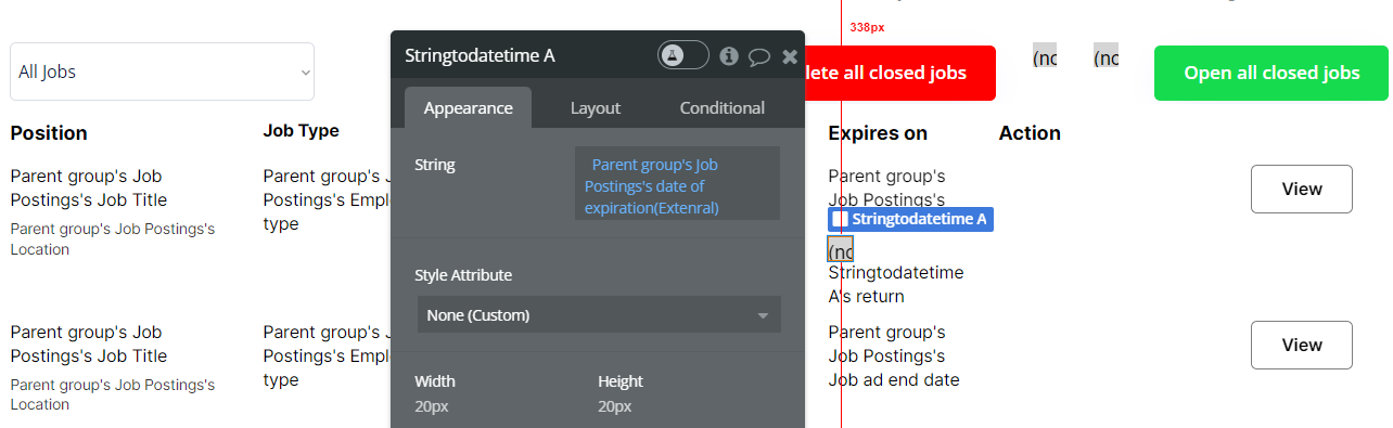

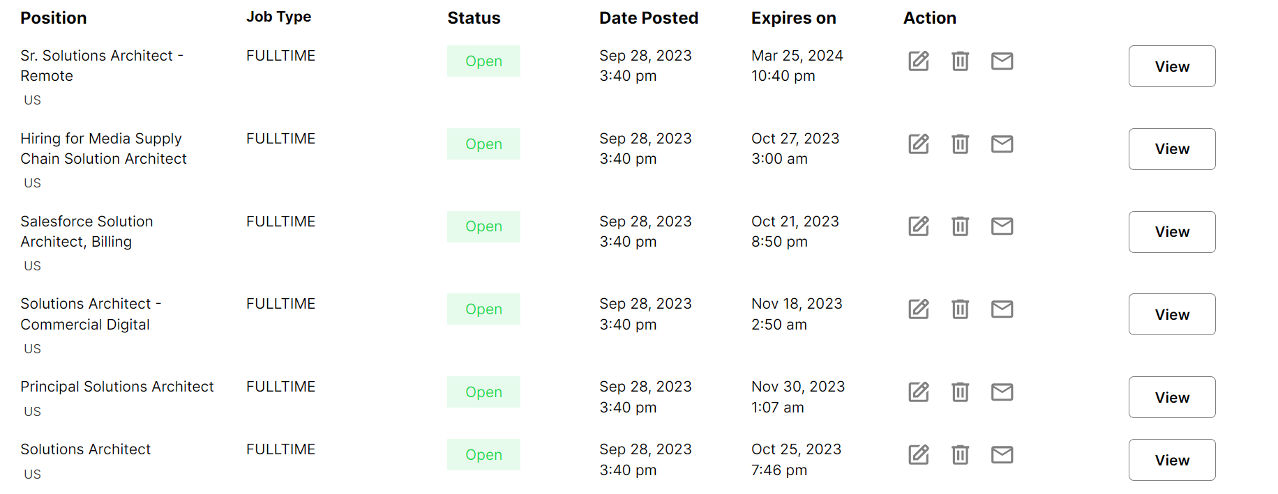

I pulled that data from a jobs scrapping API. After I’ve called the API, I send the results to the database. The API is sending back the job expiry dates in string format instead of dates. I am displaying the data in a repeating group then converting the date strings in date format. The main problem I am having is sending the dates in date format back to the database.
I have attached screenshots below
This screenshot shows how I am converting the date strings from string to date format.
The problem comes in when I try now to send the converted date displayed there as ''stringtodatetime A’s return" back to the database. For some reason I can’t access it.
