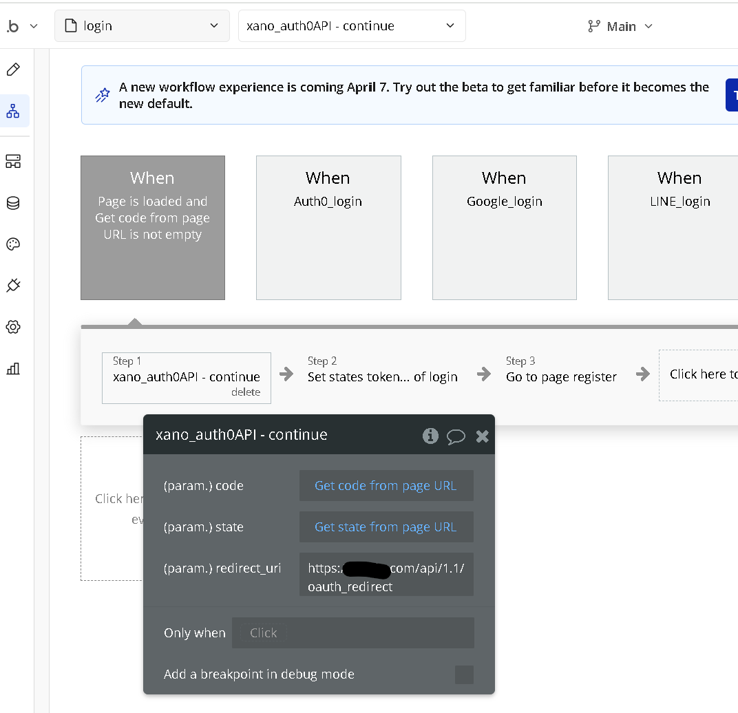

You should remove all step after open an externa website (that is probably returning an error in issue checker anyway because this should be the last step in a workflow) and instead add a workflow on page load (when get code from page url is not empty) and process to the continue step.
Thank you.
I feel like I’m almost there.
I tried separating the workflows. What do you think?
However, as it is now, the page is loaded on the login page (https://xxxxxxxx.com/login), so it seems that the continue API cannot be called.

I’m back to the page load workflow.
If I go with the latter method, is there something wrong with the relevant part?

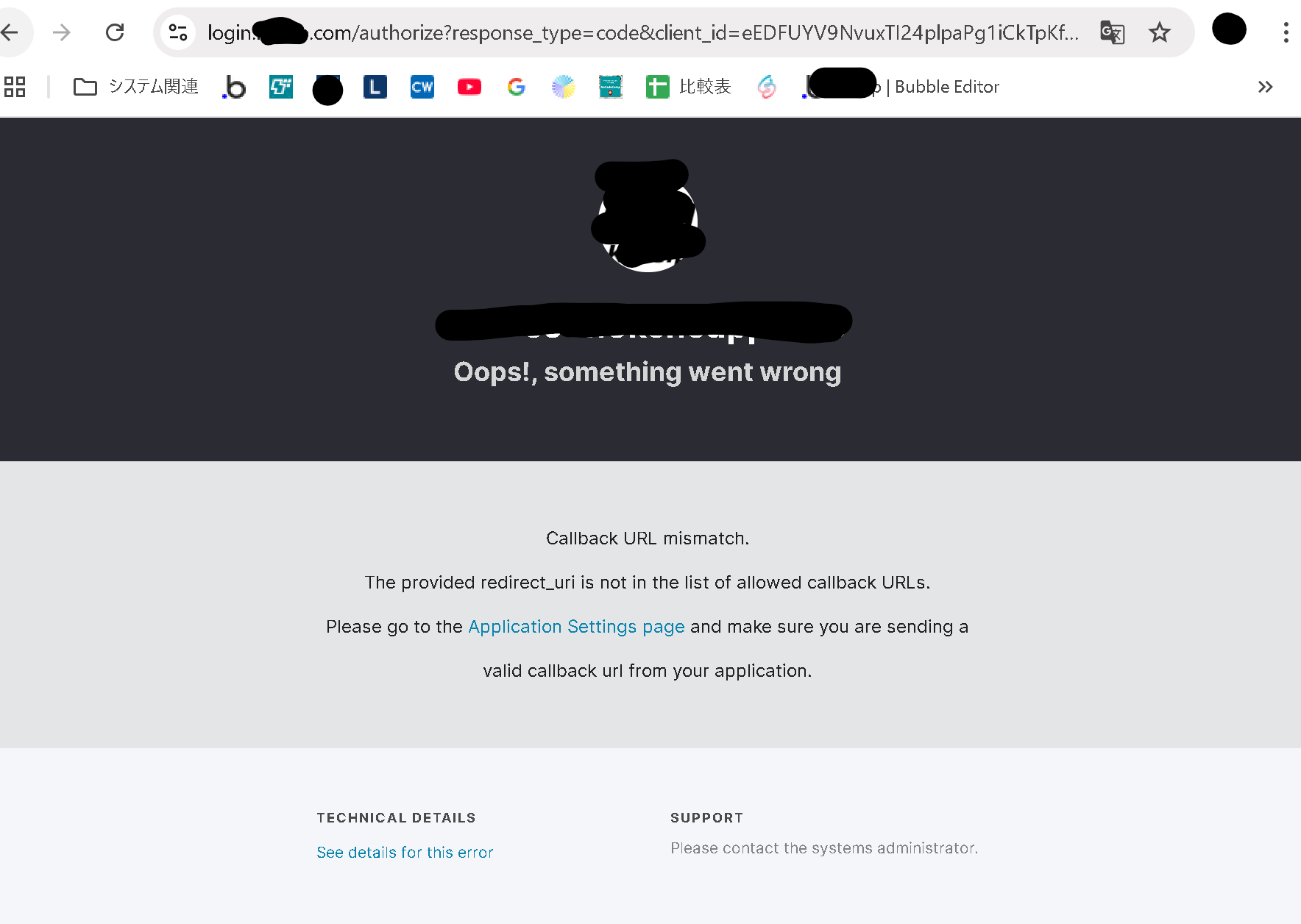

I also tried changing the URL on the Auth0 side, but an error occurred on the Auth0 login screen.

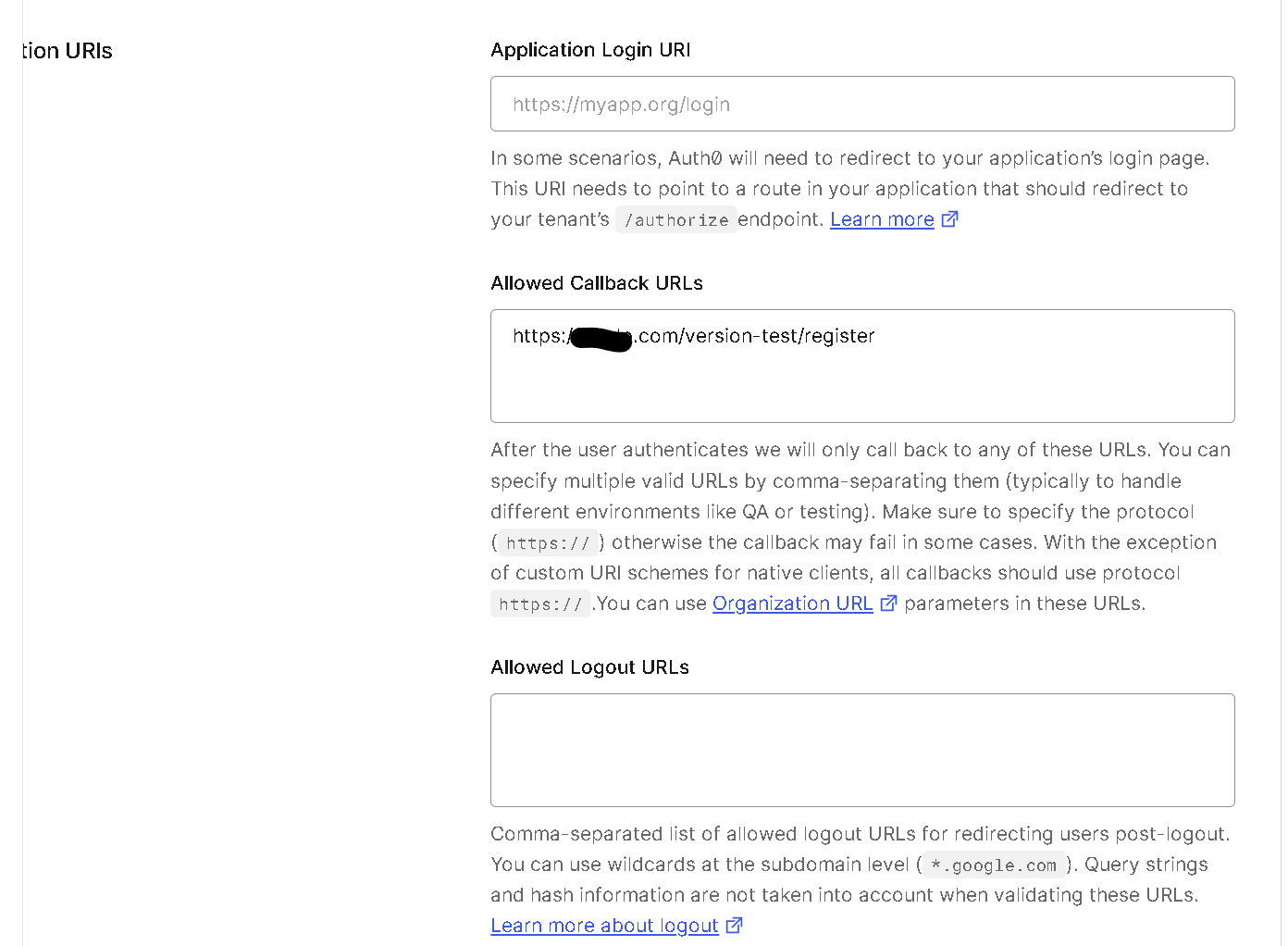

Yes, both the Auth0 Callback URLs and the Bubble redirect_uri are set to
https://xxxxxxxxxx.com/version-test/register.

The one that send the user to the auth page. This end by /authorize in your screenshot. This url.often have the redirect url too. This need to match what is allowed in oauth0
Since it is set to https://login.xxxxxxxxxx.com/authorize?response_type=code&client_id=eEDFUYV9NvuxTI24plpaPg1iCkTpKfwi&redirect_uri=https%3A%2F%2Fxxxxxx.com%2Fapi%2F1.1%2Foauth_redirect&scope=openid+profile+email
, it seems that https://xxxxxxxxxx.com/version-test/register is not included.
How can I do this?
Do I need to set it up somewhere in Auth0 or Xano?
I don’t know where to set it up.
If you are doing manual auth, you should have an action like open an external website? This is where you set that,in Bubble.
