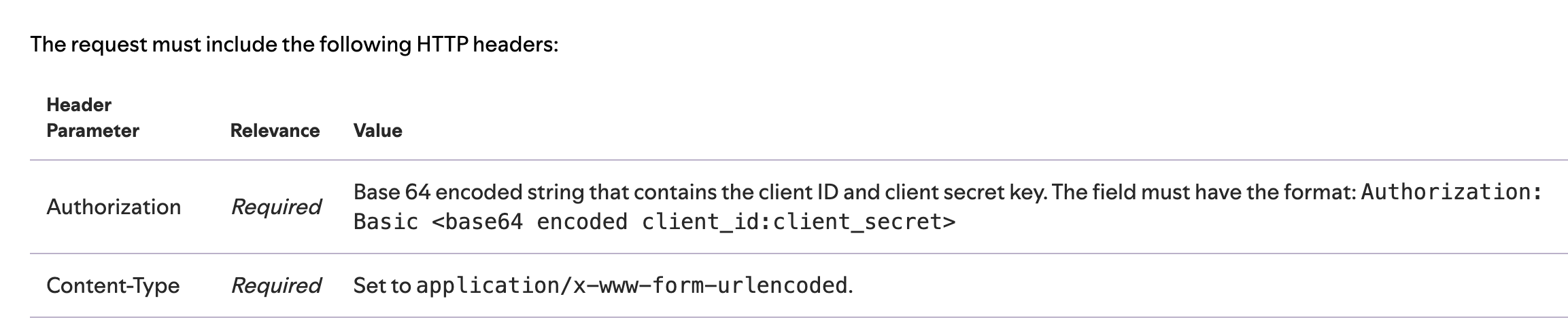

Spotify’s documentation:

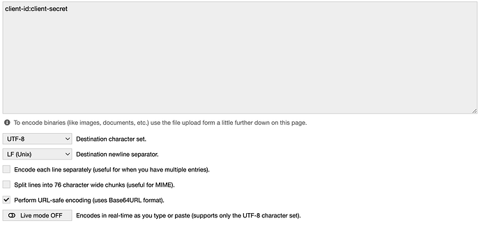

I encoded my my client id and client secret using “https://www.base64encode.org/” in the format in the image below.
Then I pasted the returned code like this. Am I doing this wrong?
