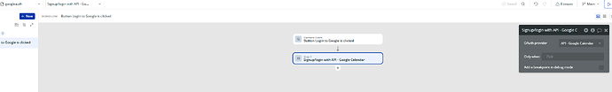

Did you “initialize” the auth in debug_mode with “Signup to social network” action? You will not be able to initialize call until this is done. After, you can add API Calls. API Connector doesn’t refresh token but this will be done for users.

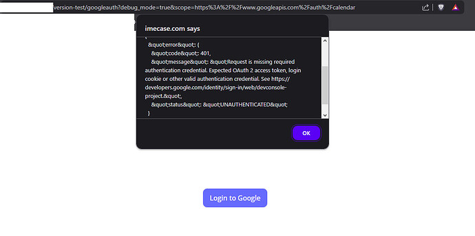

So I’m running into a wall with this as well, and have the API connector setup similarly. I get this error once I login to google, select the user, and authorize the scope:
API Connector error: the Oauth2 API Google Calendar is not configured properly - received error from API the service Google Calendar just returned an error (HTTP 401). Please consult their documentation to ensure your call is setup properly. Raw error:
{“error”:
“code”: 401,
“message”: “request is missing required authentication credential. Expected oauth2 access token login cookie or other valid authentication credential. See https://developers.google.com/sign-in/web/devconsole-project”
“status”: “unauthenticated”

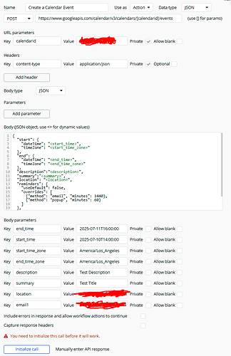

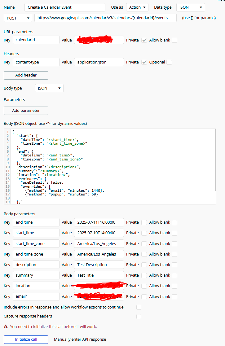

I celebrated too soon. I made my first event just after with no issue. But, then I came back later to work on more customizations, and I’m getting 401 errors again, despite not having issues with the Oauth process, at least with initiallizing. I have gone back to run the Oauth process again and it goes without a hitch, and the API connector says its correctly setup on the API. But I have remade this call several times just in case but same result each time, despite not having changing the core setup. Perhaps I have a small typo somewhere, but I can’t see it.
Below is the setup for the API call to create the event, and the response I get when initializing it:
The access token you got on the first auth initialization is expired. API connector doesn’t refresh it but it will be refreshed for your user. Do the login to social network again in debug mode and you will be able to edit calls
