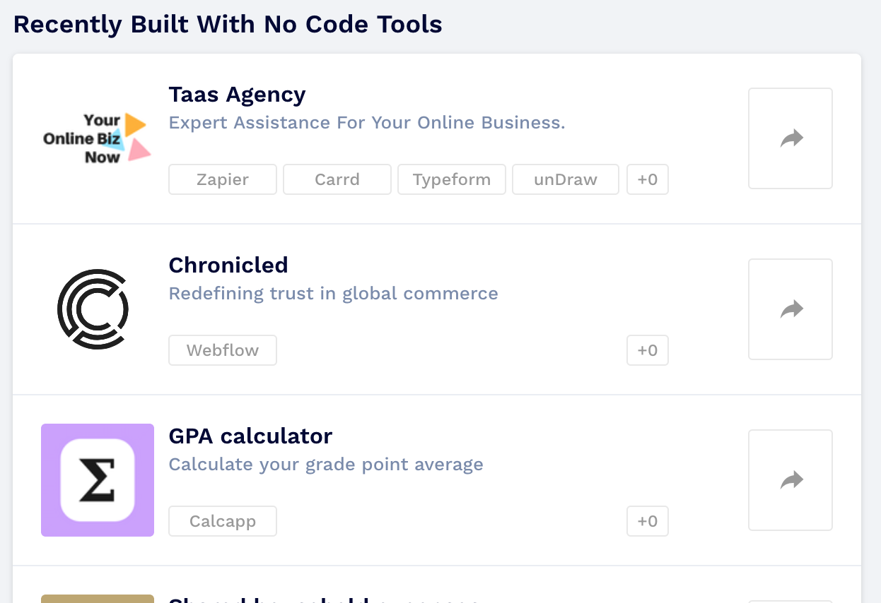

Hey @gaurav! I’m still having some trouble.
Just so everyone knows, this is actually a new little feature I want to add for NuCode.co :slight_smile:
I did just buy the repeating group tool as you mentioned, but guess I should’ve looked through the docs beforehand to make sure.
For this setup I need to have the “+0” boxes show the number of tools that specific product is built with:
For example, Taas Agency on the top is built with 1 additional tool than the 4 shown, so that would say “+1” instead. And as users are on mobile, it might show 2 tool tags, and then have a “+3”. The 2 visible tool tags + 3 other tags would be the 5 tools it is built with.
So this would be super easy with RepeatingGroup tools plugin.
The output of the element will only be generated for the cells that are visible.
So you can subtract the :count of output with the total number of tools you have, and set that as the +X number :slight_smile:
