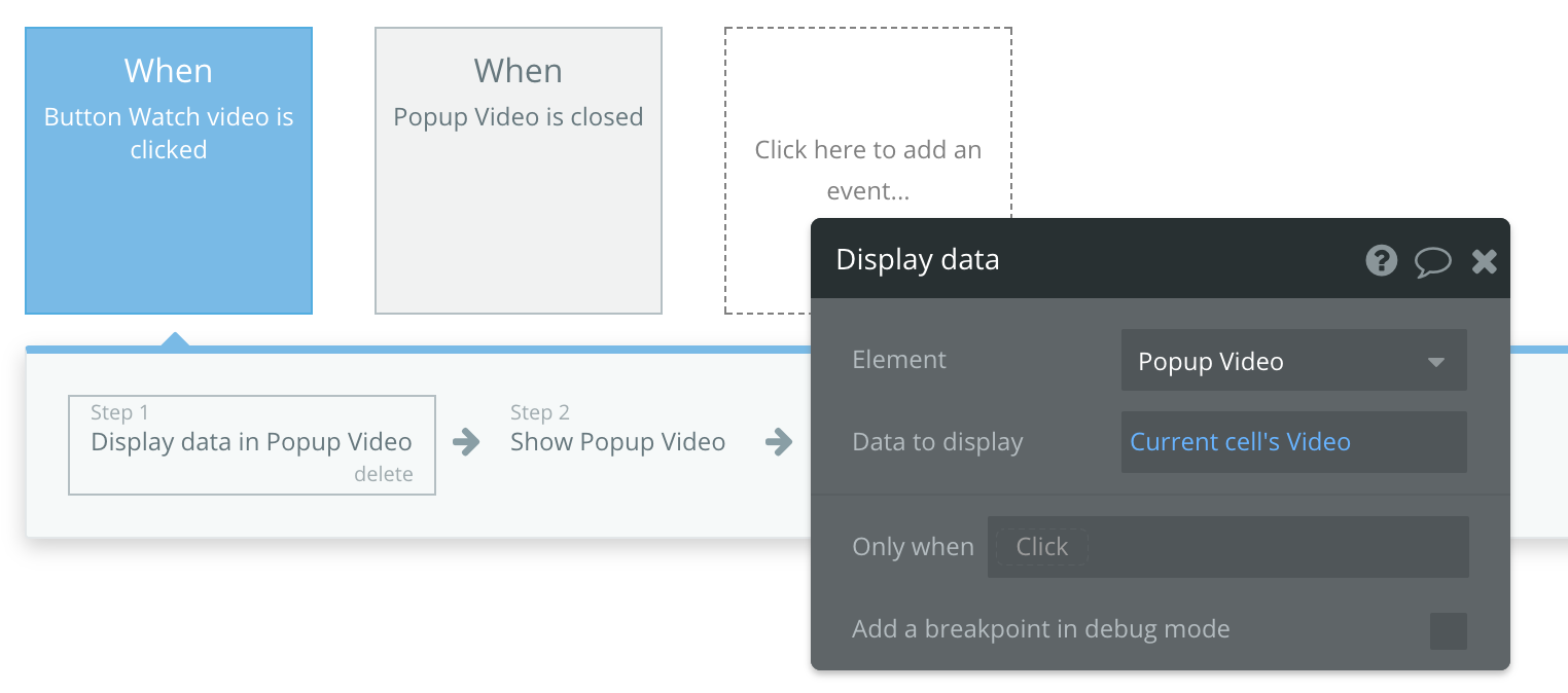

On this page, once Watch is clicked, that cell’s Video data is displayed in the popup:

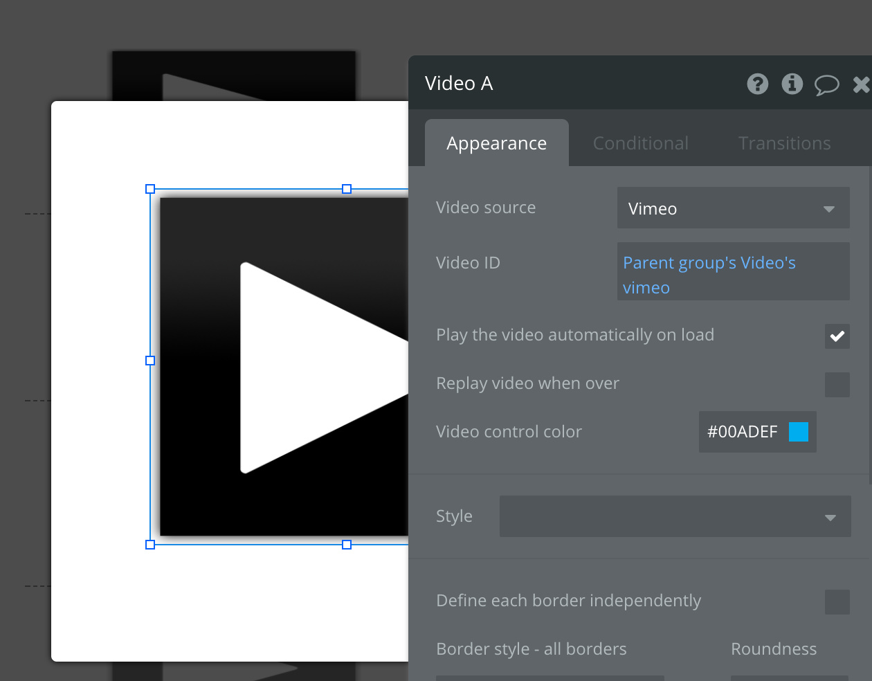

The setup for the popup is:

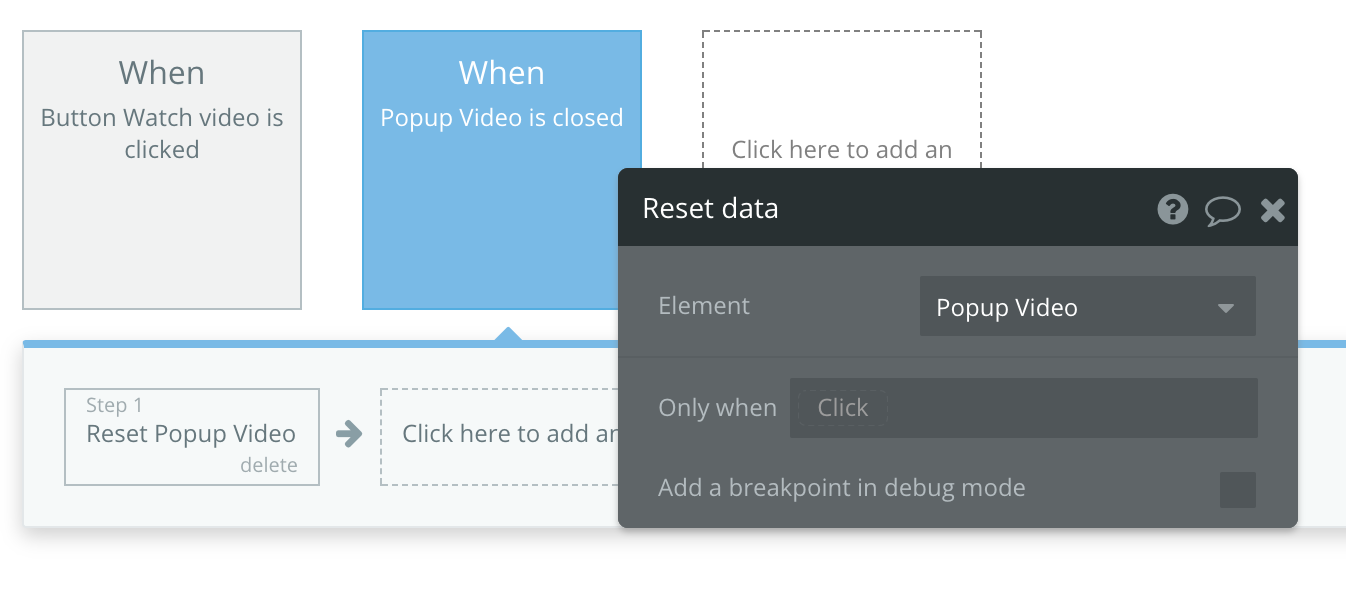

*The data source is empty by default, so that when it resets once the popup is closed, it doesn’t continue to play a video. The data source is only not empty when data is sent to it after clicking “Watch”.
Here the data source of the video player is the Parent Group Popup’s data source, which is displayed depending on which repeating group Video cell the User just clicked on.

When Watch is clicked, the selected video is displayed in the popup and plays automatically:
When the User clicks out of the popup, the popup ‘resets’, and the video stops, when the popup is closed.
