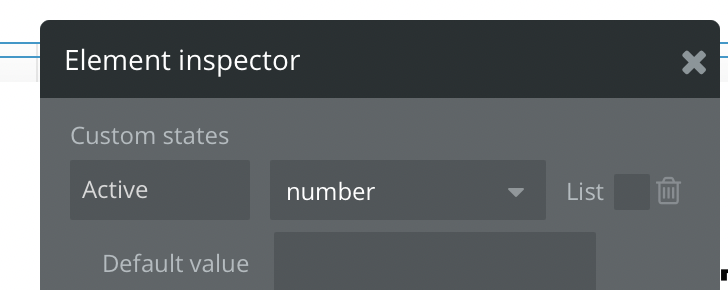

Thanks for the reply. I think I understand what you’re saying. I’m having the same issue though. See below:
I changed the custom state from binary to a number:
I set the style condition to be when the cell is hovered or the active state is the current cell’s index:
I set a workflow to set the state of the current cell’s index to active:
Still sets multiple cells to active:
Any idea what I’m doing wrong?
I could be way off here, but try putting the custom state on the repeating group itself instead of on what I assume is a group within the repeating group.
Awesome - that was it. Thank you!
