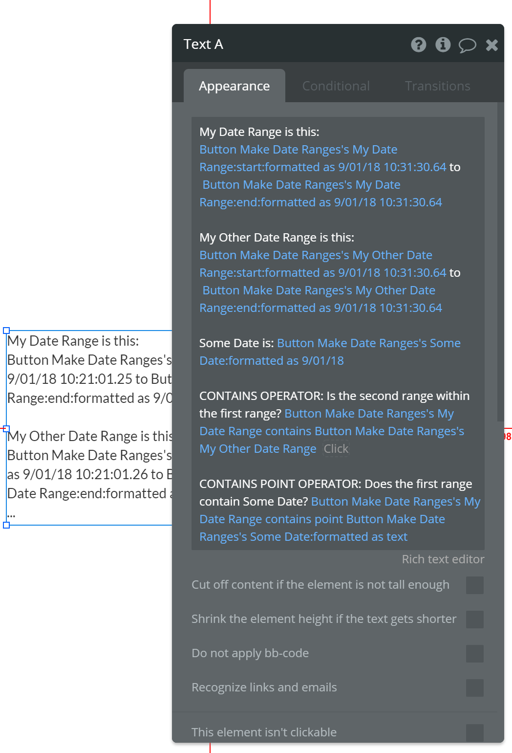

My Date Range:contains My Other Date Range will be “yes” if My Other Date Range is entirely within My Date Range.

So now we could check if that date is inside of one of the previously constructed date ranges like this:
My Date Range:contains point Some Date will be “yes” if Some Date is after the start of My Date Range, but before the end of My Date Range. It will be “no” otherwise.
Let’s put this into practice. Here’s the page that executes the workflow action I’ve been describing. When the button here is clicked, it makes these date ranges and dates. Then a text element tells us about them:
The expressions which yield these results are shown here in edit mode:
