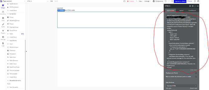

Hello,
I am developing payment page,
and Paypal gave me ready-to-use HTML code which should be worked, when copy & pasted.
However, even though I copy & pasted the HTML code in HTML element, (which should be worked then)
I couldn’t find any button neither in working nor preview page.
What I want is to make button to be seen in HTML element.
If there is anyone who knows the solution, or went through the same problem, some advice would be much appreciated.

To reproduce the issue, I copied the demo script from the paypal homepage.
The above page was found on the paypal developer dashboard page.
https://developer.paypal.com/dashboard/
I added the following code as an html element.
https://pastebin.com/eLJ0LCG7
Note that you need to replace the client ID inside the with your Business Account app client ID.
You can find your own test client ID here. Developer Dashboard
I enabled the “Display as an iFrame” option in the appearance settings of this html element and it looks fine.
