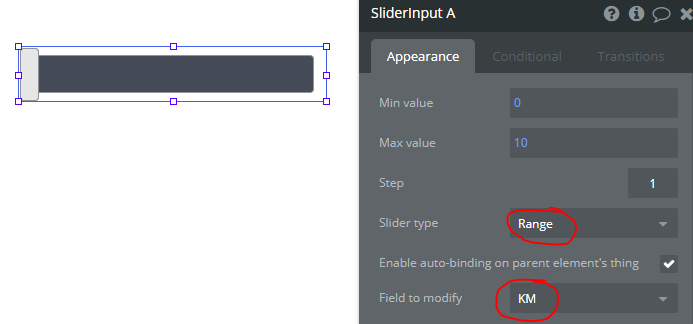

What you have to do first is to set a field to the type numeric range
Then, you can save those values using for example a Slider Input element

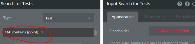

And then it's easy to search for the record that matches the value like this
Please make sure you’re using “Contains(point)”.

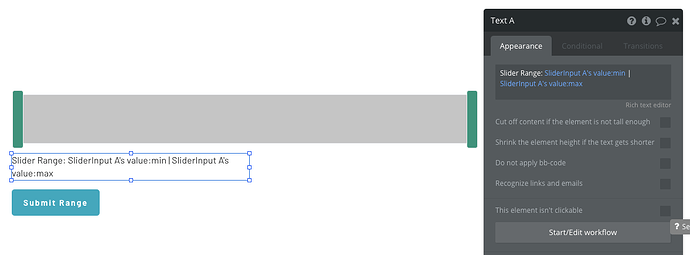

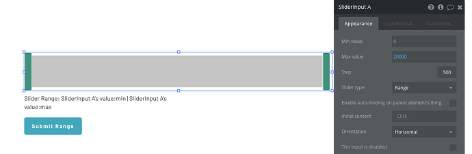

  1. On a new page I inserted a slider input, a text field to show me what those ranges were as I moved the slider, and then a submit button to set up the workflow to submit the data to the correct table and field.
  1. Here’s the workflow:
  1. That submits the ranges to my Data type field I set up in step one called KMRange (the values for each range you can see, 2 & 5, I just manually entered after the range was in there)
  1. Then on the page I want to show the value for that range, I inserted a text box that does a search for the record and uses Contains(point) in the constraints for the search. It gets the K value (which is my Number of KMs) from the URL.
