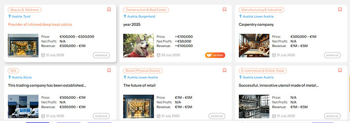

In my repiting group the listings have prices from option set for example: up to 10, 10-50, 50-100 etc. How can I make sorting and flitration of repiting group by these option set?

I have a repiting group with companies with the price from the option set described above, and I need to configure sorting by these prices

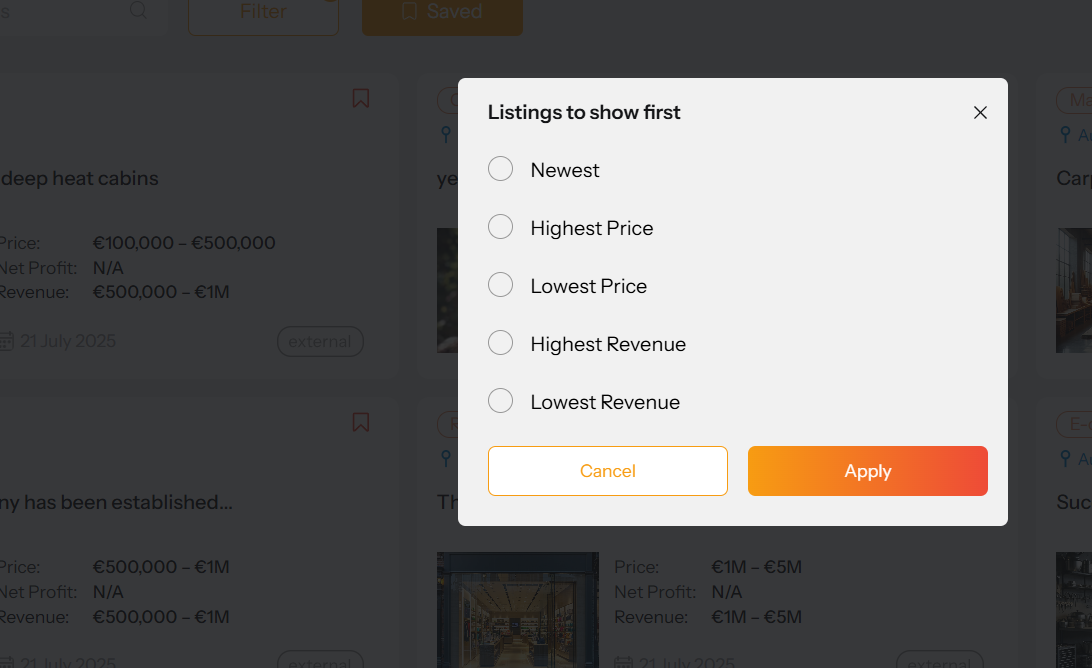

If you have a dropdown that is populated by an option group…
and then set a constraint on the repeating group based on that dropdown. Are you saying that won’t work?

At first look…
this doesn’t seem complicated, unless (I’ll mention that in a minute).
The newest would just filter the repeating group by the created date.
I would add 2 number types to the data. 1 would be for the lowest price. The other would be for the highest price.
You could then filter the repeating group based on these prices.
As far as revenue, this is where I said it could get complicated. IF the highest revenue and the lowest revenue is a fixed number, you could add that to the database.
IF the highest revenue and lowest revenue are always changing based on different factors, this could possibly be another data type connected to your main data type.
So, everything would be simple to set up, but the highest revenue and lowest revenue would depend on how you calculate that, if you do.
Added: If your lowest revenue and highest revenue are a fixed number, that’s even easier.
Just add a data type for the lowest revenue, which is a number, and the highest revenue, which is a number. You could then just sort the repeating group based on this.
This would be the easiest. But, if, as I said, this is calculated daily or weekly, etc., it would change how you set up the lowest and highest revenue.
