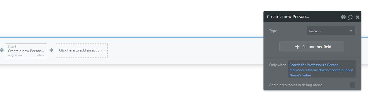

So, I’m trying to do that:
Create a new Person only when the input name is not in the table Professor…
in the constraint I would like to access the Person reference name
I also tried that, but I think contains in this case can genarate many bugs:
Sorry if this is a stupid question, but I’m struggling to understand
Thanks again, vincent.
Make sure that if a database field is an Object, make sure that your Input field also outputs the same Object. That is what is going wrong in your top screenshot.
I don’t know what the Input Name’s value is but if it is an Object, then it won’t work. But if it’s an Object’s Reference, then you can use it in the constraint.
For searching for things as the condition, make sure to select ‘first item’ to referece the first item in the list that matches the constraints.
However, I think you are overcomplicating things here. If this needs to go in one workflow you could do soemthing like this:
Step 1: create new person > Step 2 > Create new Professor where ‘Person is result of step 1’, only when step one is not empty.
The point is, there are 100 ways to get to your end result and the example you give now will probably not be the correct approach for what you need. But the only way to find out is to just continue down this path. You will eventually think: ‘Oh wait, this actually needs to be like this!’ Boom, level up
