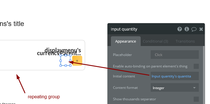

In a repeating group i have a series of input with its state called quantity
the initial state of the input is state quantity

Thanks but its not involved any db i need just to reset this field as u can see in the image.

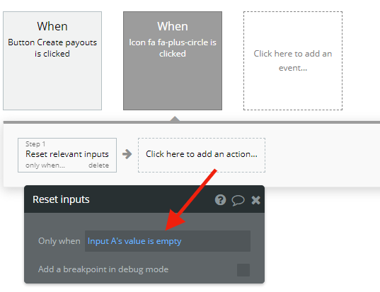

@rcretella

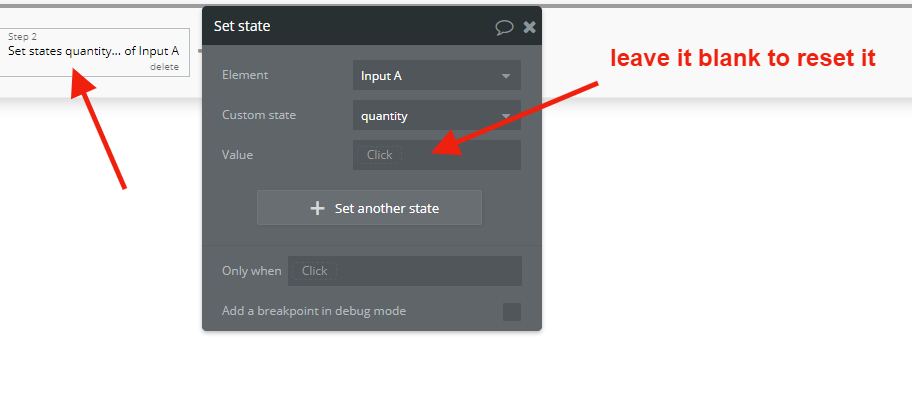

I used an icon in the row as a trigger. The action to reset the input could be this one:
