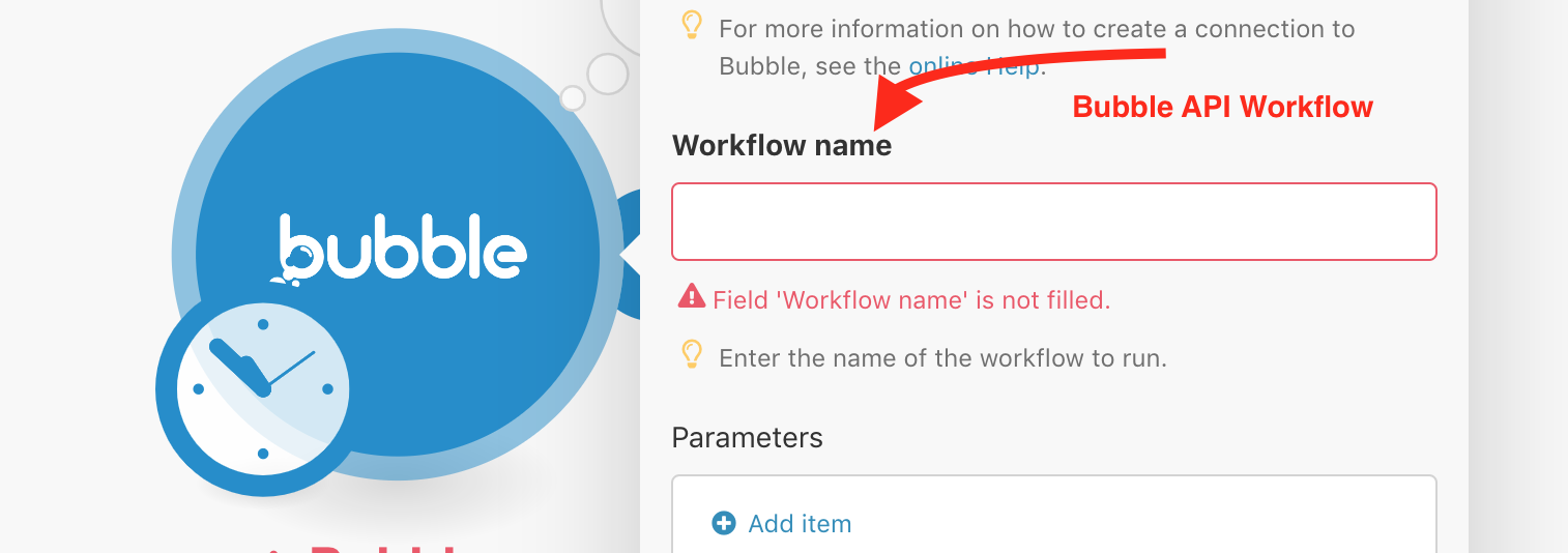

And why do you think that Bubble API Workflow is better than Workflow name? I think latter is easier to understand.

Simply because Integromat calls are only made to API Workflows (with S)
and not from the general Workflow app. A little confused I have to admit.
Also free Bubble account don’t have access to API Workflows.

Alright I understand. Will get that changed. Thanks!
It has been updated @JohnMark!
