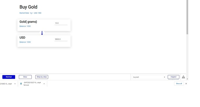

I have 2 interdependent input fields. The value in the fields is calculated based on the input number in the other field.
Example: If Gold = 10 then USD should be 9800 ( = 10x980)
Alternately if input USD = 980, THEN the Gold should reset value to 1 (= 980/980).
Please suggest ways to implement this logic

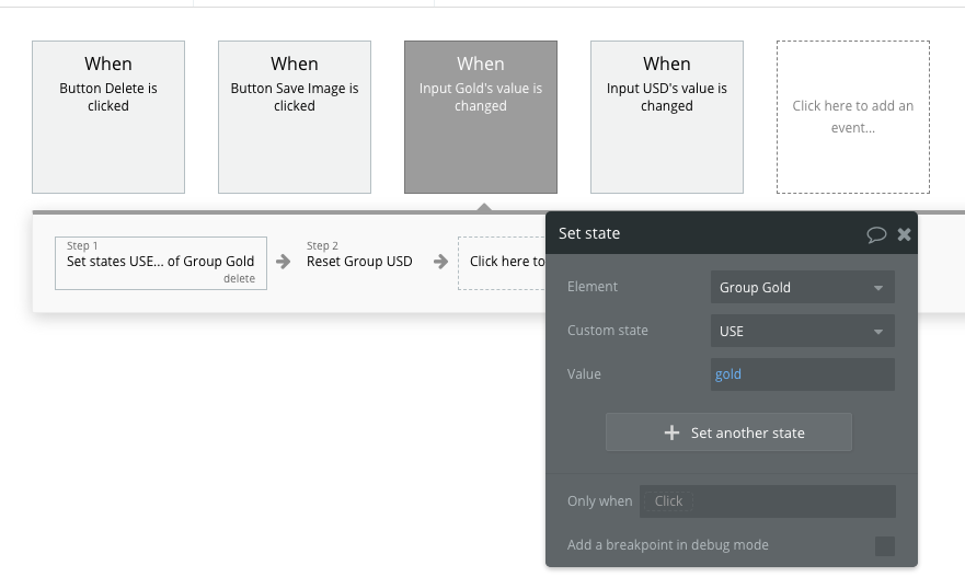

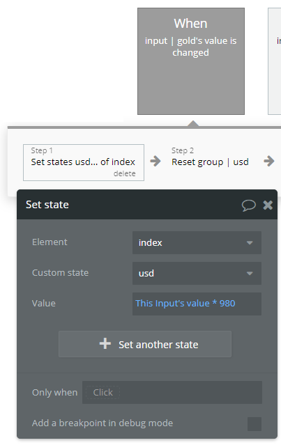

Hi there, @ajitsahu2… if I understand your post correctly, I think it’s a bit more involved than using conditionals on the elements (no offense to @ecomerss, of course). I put together an example that seems to produce the desired result, and the way I went about it involves two custom states and a workflow on each input element.
First, I added two custom states (with a type of number) to the page, one for each of the inputs, and I set the Initial content of each input to its associated custom state. Then, I added a workflow so that when gold’s input is changed, the custom state for USD’s input is set as follows…
Oh, I also have each input in a group, and the second step of the workflow resets the group for the opposite input because if there is already a value in the input, the value won’t reset on its own to the value of its associated custom state.

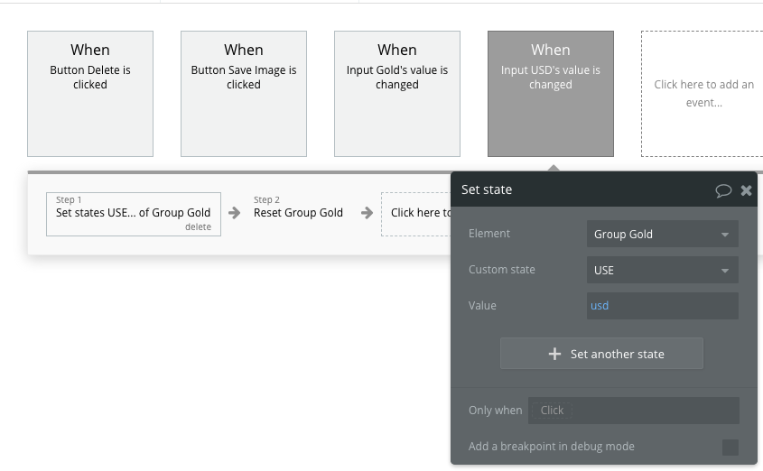

Anyway, the workflow for a change to the USD input looks the same aside from the fact that the calculation divides by 980, and the second step resets the group that contains the gold input.
Who knows, maybe I overcomplicated the whole thing, but again, my example does seem to produce the desired result, and I hope this helps.

Thanks, Matthew. You are articulate. The suggestion indeed works.
