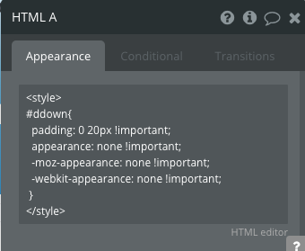

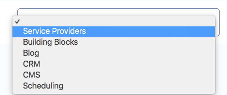

I’m trying to implement the Remove Default dropdown styles but seems like nothing is changed
Screen Shot 2021-02-18 at 5.06.49 PM
This is the setup as explained in the snippet
Screen Shot 2021-02-18 at 5.06.23 PM
Any ideas what I’m doing wrong?
