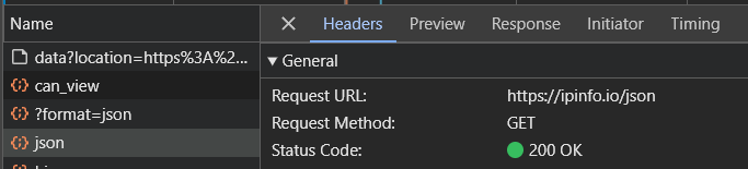

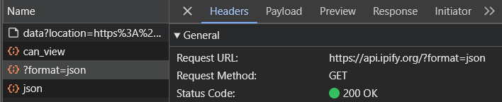

I have tested Ipify - https://api.ipify.org?format=json and IPinfo - https://ipinfo.io/json, both return correct ip address when used as data source on frontend. Here are the API setups
As far I understand, whenever we initialize any API call even with “Attempt to make the call from browser”, it still goes through Bubble server at the time of Initialization. On frontend, it returns user ip-address if we setup correctly. Please check Network Tab under DevTools when initializing the call.
To test on frontend, just use a text element with “get data from external API” to retrieve the data. Also, check the Network Tab.
Note: Under certain scenarios, this API call can revert to being called from Bubble server. Please check the Bubble manual - Adding calls | Bubble Docs.
