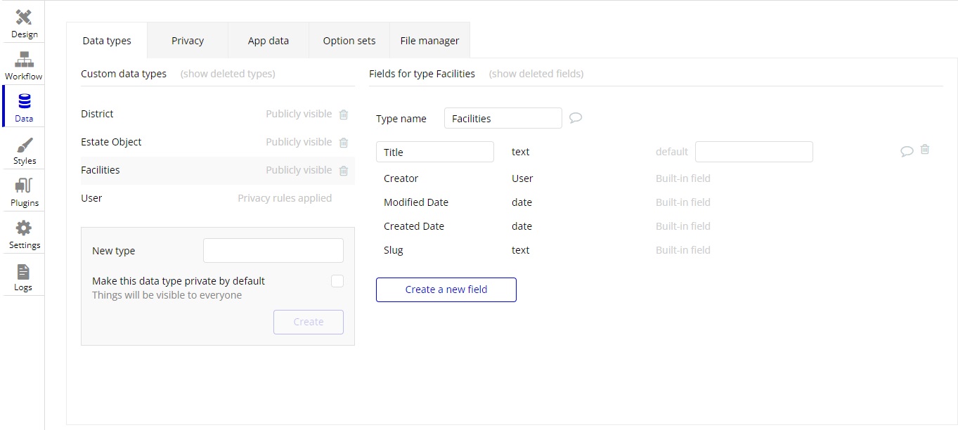

Can you please send a screenshot of your DB app data where these facilities are stored?
I have type Facilities for arranging RG on page, Option sets with list of Facilities for easy way to arrange every object, and Field Facilities in each object to contain all set facilities in one cell.
It’s much more work for me to try and visualize everything. Can you please send a screenshot of your app data and your data types. You can redact the data if you need.
The main problem is when i set filter: Facilities contains RG Facilities’s Selected - it needs more… how to end a condition?
When you are clicking the multiple tickboxes, are you storing those tickboxes selected into a state which is a list of values?
Of course. Almost the same filter works, but it filters the cells of objects with a single value. Here i need to filter the cells of objects with multiple values
Can you send a screenshot of your current filter settings?
Your repeating group has a state called selected, which based on the red text, is not the same type as facilities. What state type is “selected”?
Try changing your “Facilities contains…” to “Facilities contains list…” in your list filter
