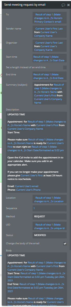

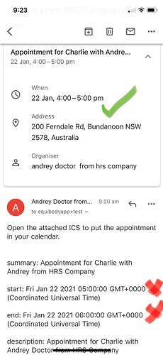

I’m trying to set up a workflow of a new or modified AirCalendar event to send meeting request via email. I can get the email to send and the ical etc works great (it creates an event for the correct time in recipient calendar), but I’m having issues with when the start and end time that displays in the email - it doesn’t display the correct date and time - I think it might be displaying a different timezone? iCal brings correct timezone, the calendar view in the live app does, but in the description it seems to be bringing back a different time zone.

What you should do is check the box in the email workflow that is at the bottom of the dialogue and is named “Change the body of the email” then you can write whatever you want in the email and can add the dates/times in any format you wish them to appear.
Currently this is set up to send the times in Coordinated Universal Time AKA UTC AKA GMT+0000 which is why you are seeing that after the end and start times.

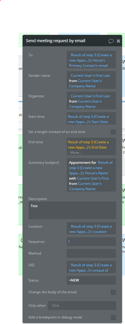

In your image start time and end time where is says "Result of Step 1 (make changes to a)'s Start Date is click on it and add more dynamic data which hopefully there should be a format option
@johnny I got really excited for a minute! But then…:frowning:

@johnny, see my first post for how it displays. It’s correct at the top bit, but in the description displays in the wrong time zone, even though it’s coming from the same dynamic data. Weird and really frustrating as it should be straight forward!

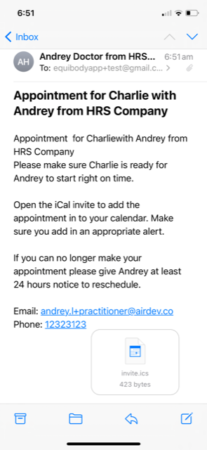

I’ve worked out how to make new and modified events work correctly via the apple mail app (displays a nice banner in the email to add or update depending on which it is, and does actually modify the existing calendar entry). Gmail app doesn’t play nice, shows appointment nicely but no ‘add’ button to add it into your calendar. This seems to be a specific problem with the gmail app and ical from my research.

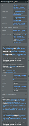

@boston85719 my last post I showed how I had set it up and made it work using your suggestion :slight_smile: , I added in start and end time in to the body text and it allowed to me custom format because it allowed displaying as text (start and end date fields don’t allow this).

@J805 I’ve already emailed bubble support and working with them too :slight_smile: But yes, adding start and end date into the body text made display nicer in both gmail app and mail app :slight_smile:
