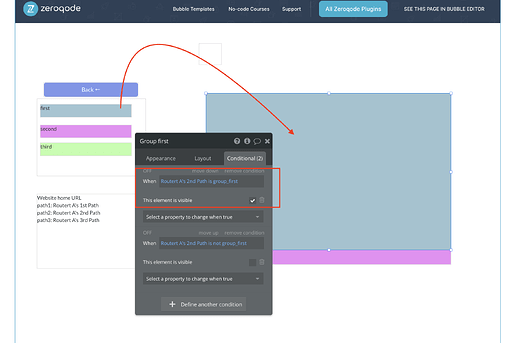

First of all, the reason why the URL is changing, but the desired group is not visible is because of the condition that you’re using to relay on the custom state’s value. Here the problem is your custom state’s value changes when you click the group’s name on the sidebar, but not when you click the “back” button. Therefore, we recommend you change your setup and use the plugin’s path.
Besides, we need to point out that our plugin is not recognizing the “back” browser’s button action, that’s why we have a “go back router” action to trigger a button. So, please use it instead to go back to the previous URL router’s step.
As for the 404 error, since our plugin is not changing the actual page/app structure, but just changes the look of the page URL, it is expected that you get the 404 error on the page load, which URL contains an unknown page name. But, there is a workaround that might be useful for you.
So, if we indicate the main page name (in your case it’s profile) to our URL and use this name in the “Change URL Router” actions, especially in the Page is loaded event. The Bubble will be able to understand which page to go on page load as it will be a known page name. For example:
Also, you can take a look at our test page for a better understanding: Zeroqode-demo-17 | Bubble Editor
Hope it helps.
