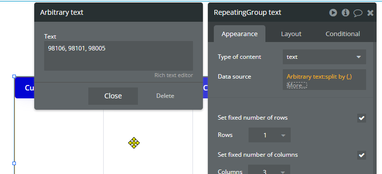

Setup:
Preview:
Here is the editor if you want to see for yourself: Tests for Forum 10 | Bubble Editor

It looks like there is a problem in the design. But If this design is intentional, then, you will probably have two repeating groups. Outer is for the Onboards, and in a cell of this outer, create another repeating group. Inner repeating group’s data type will be text and data source will be current cell's service_zipcodes: split by(,).
