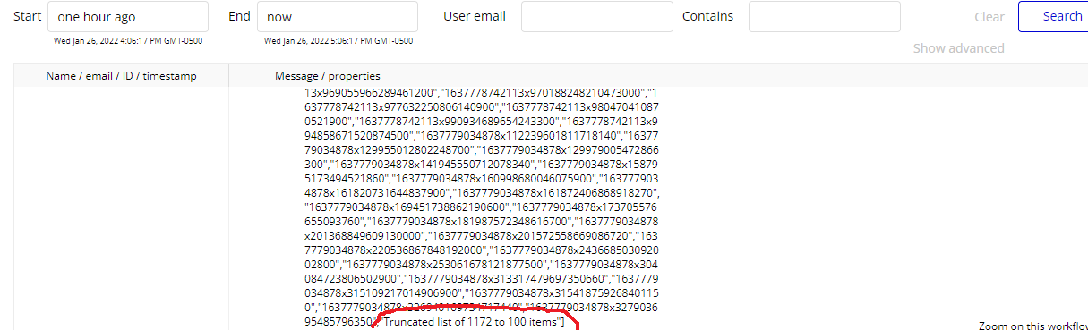

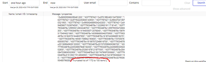

Anyone seen this recently?
Looks like you can’t pass lists around anymore ? Or is that just something that is in the Log?
pretty sure this is just a log thing

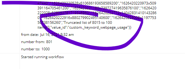

Hi @NigelG, this just happened to me as well when trying to delete a bunch of records using a backend workflow:
It seems like the deletion process was stopped.
Any ideas on how to bulk delete around 1500 records successfully?
That message is just saying “we ain’t gonna log 1172 items, so here’s the first 100.”

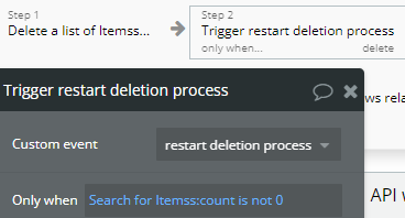

I found a pretty simple workaround to delete massive amounts of things using any constraints that you’d like through Backend Workflows. This might work also if you’d like to bulk modify lists.
Here it is:
  1. Create Backend workflow A.
  2. In Backend workflow A, Step 1 will be a delete action for the list of items you want to delete until item #99 (apparently trouble happens when you set workflows on lists of +100 items).
reslult
  1. Create a new backend workflow that is a Custom Event. This custom event will re-schedule Backend Workflow A every time that it is triggered.
  1. Put this custom event as the Step 2 in Backend workflow A. Set this custom event to trigger Only When the count of items in the list that you want to delete is not 0 (it will trigger as a cycle for every 99 items until there is nothing else to delete in your list).
reslult2
This worked for me. I hope it works for anyone else who needs it!

The trouble is, in my case, that it stops deleting when it reaches item #100.
If you see the “Copy” action in Bubble it says it will only work for max 100 items. They might have some limitation when handling processes of more than 100 items for other actions as well.
This worked for me, it doesn’t matter if it takes items that are still marked as deleted because it will just keep deleting the first 99 items on your search results on a loop, until there is nothing else on your search results.
The speed of deleting, in my case, was around 100 records deleted per second.
