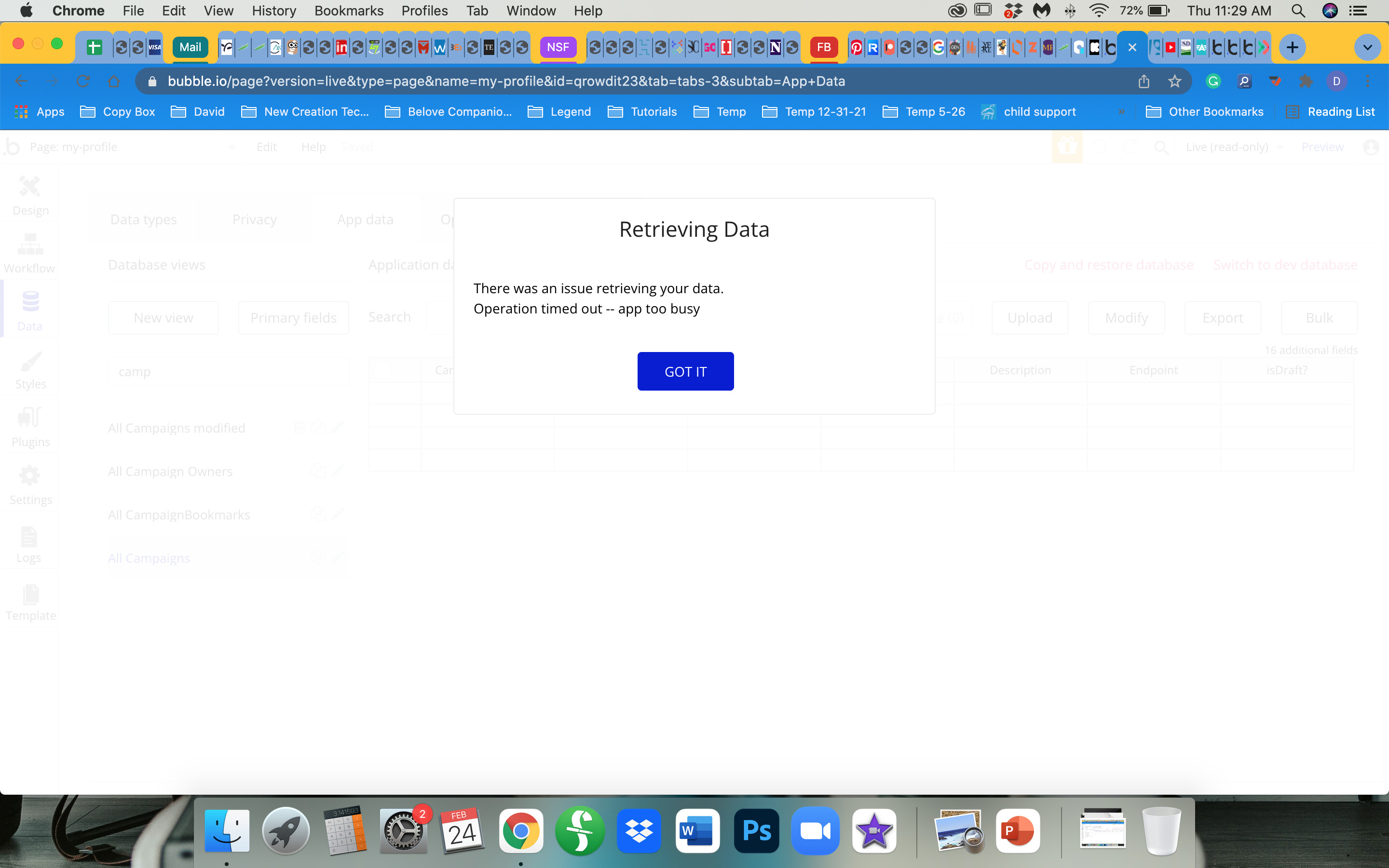

Yea I did that. This keep showing up.
I don’t think I’ve ever encountered that message in that context. If it occurs consistently (and sounds like it does), it might be worth submitting a bug report for that specific issue. Attach that screenshot to the report as well.
yea did that as well too. They couldn’t find anything wrong with it or why it is doing that. I’ve given a video of the walkthrough of the issues I was having in Live compared to development
So were they unable to reproduce the issue, or did they just say there’s nothing they can do (which would seem odd)? Are they still investigating?
