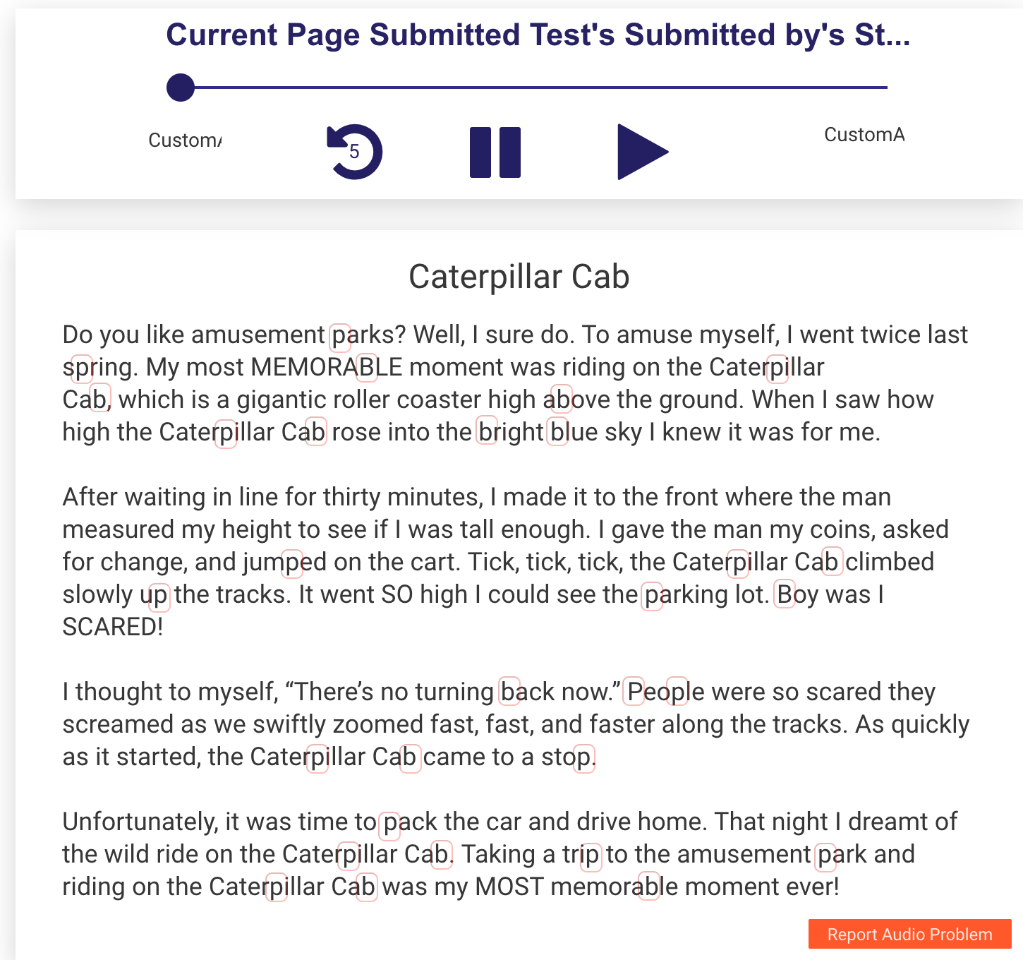

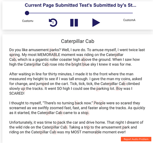

Context: A test is a student recording themselves reading a passage out loud and submitting the audio recording for a teacher to review. The teacher listens to the audio and clicks the sounds that the student is saying incorrectly. Each of the little red transparent boxes are possible errors. Each error box represents a sound that could be incorrect. The reason I feel like I have to make each page individually is to create the little red error boxes over the words. (screenshot is of 1 grading page.) Each test has a different passage to read and different sounds (words) that a student could pronounce incorrectly.
Any ideas on how I could better accomplish this? If there were a more dynamic way to do that we might also solve the other issue.
I would create a single page called “grading”
On that page I would have groups that are set to data type “test”
To set the datasource of the group I would "do a search for test - constraint - ID = Get data from URL parameter ID "
What this will allow for is the group to be set to the test that has the same ID that is in the URL so that you can use the links as we discussed.
So on this single page, you would have 1 group if you are going to make the data concerning errors dynamic — in the database for that particular test for that particular question you could create a data field that is a list of possible errors — this of course would take some time to ‘map out’ the database to correspond correctly
IF you already have a database set up which is causing you to use 15-20 static pages, this single page could have 15-20 groups and create essentially a ‘single page app’ within your app…single page apps have groups that are aligned vertically and are ‘set to collapse height when hidden’ and have conditionals on when to be visible or not visible (‘hidden’ or ‘not hidden’)
This way the groups do not affect the height of the page when they are not visible…so each of these 15-20 groups could be static to make life easier in the case of a database that is already set up to necessitate static grading pages. Think of the 15-20 static groups as a replacement for the 15-20 static pages…then your conditional on when to make the group visible or not visible is again based on the ID value in the URL
