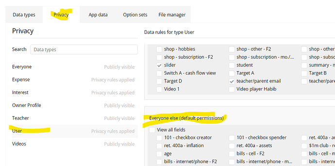

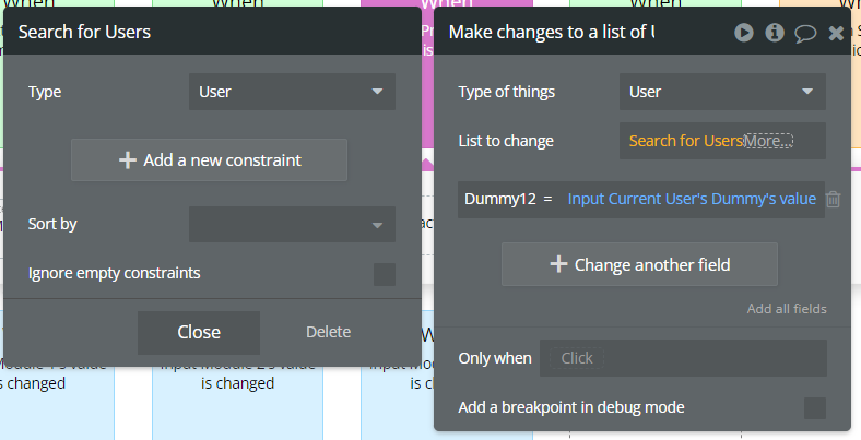

How about this. Instead of an option make it a user field. When a user makes a change you can use a workflow to modify every user’s field to the same. Does that help?
To do that you need to update the privacy on that field so all users can access other users’ field.
No that doesn’t help and would be a very not good way of doing it (and very expensive).
@clement4 do what @Zeroic reccomended above :point_up:
What is the expense?
Searching things and updating things takes up WU. That’s besides the potential timeouts and the terrible practices which are the primary issues
