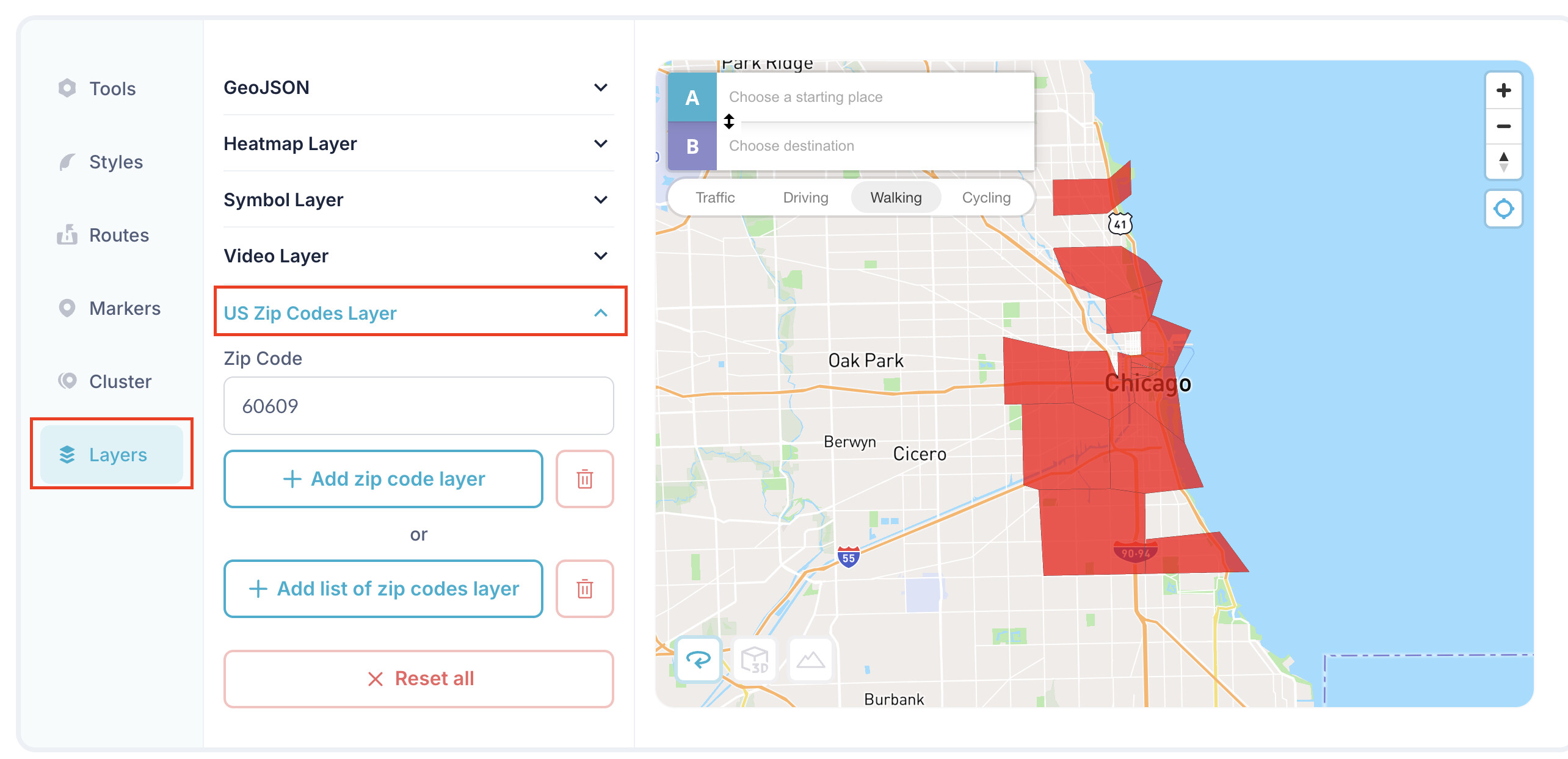

We’re excited to announce a new feature in the Mapbox Maps plugin designed specifically for U.S.-based projects. You can now display and interact with ZIP code areas directly on your map!
To get started, simply use the new “Create US ZIP code area” action and input one or multiple ZIP codes in the dedicated fields.
Once added, the plugin will neatly draw the ZIP code shapes on your map. Plus, we’ve included event and states that let you further customize your interaction.
You can give it a try on our demo page: https://zeroqode-demo-08.bubbleapps.io/mapbox_maps
As always, feel free to reach out if you have any questions or need additional assistance. We’re here to ensure everything runs smoothly for you. :hugs:
Ensure you’re using the latest version (1.159.0), which disables the “Map is clicked” event when interacting with other map layers.

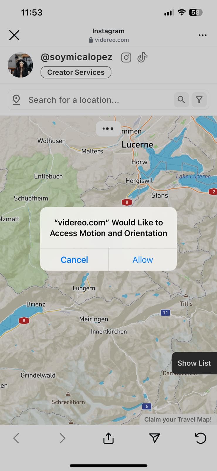

Hi everyone - we get this message if a user opens the map on mobile (just tested on Safari on an iPhone). Do I have a setting enabled that triggers this?
Thank you!
Hi @a.villabruna ,
Thank you for reaching out! :pray:
This is an essential setting that allows the app to access the device’s motion and orientation data, which is often required for features like GPS tracking, compass functionality, or tilt-based interactions. On iPhones, Safari triggers this prompt as part of Apple’s privacy measures, ensuring users grant explicit permission before the app can access these sensors.
You should see a similar message on Android devices and even on desktops (MacBooks/PCs) if the browser requires user consent for motion-related features. If this is affecting the app’s functionality, you may want to check whether the necessary permissions have been granted or if there are additional browser settings that need adjusting.

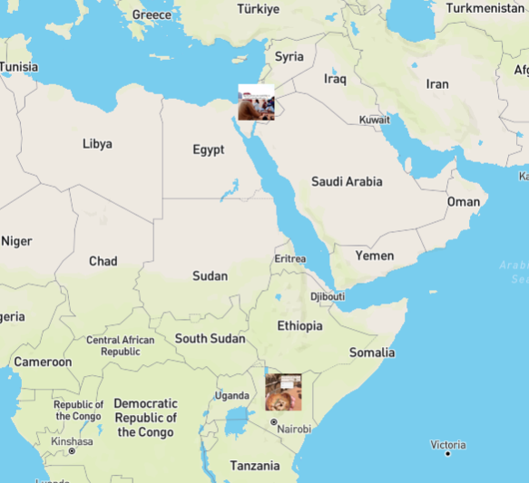

Hi @ZeroqodeSupport team - I stumbled over this response. I wondered if (and how) I could style my custom markers. My source outputs the images in a square, but I would love to make them round, with a white border. Is this possible?
Hey @a.villabruna ,
Thank you for contacting us.
The Mapbox Maps plugin displays pre-prepared images for the markers, meaning it doesn’t provide built-in options to style the markers (such as making them round with a white border) directly within the plugin settings.
However, you can achieve this effect by preparing your images in the desired style beforehand. You could create round images with a white border using an image editing tool and then upload them as custom marker icons.
Have a nice day!
Best Regards,
Zeroqode Support Team
Browse all Zeroqode Plugins for Bubble
Banner_Last3
Thank you. Unfortunately, this is not an option. So, is there no way to style these markers with CSS? I saw someone earlier in this thread who was able to style the geocoder box with CSS.
Hey @a.villabruna ,
Thank you for your reply.
Unfortunately, the Mapbox Maps plugin does not provide built-in options to style markers using CSS. The plugin only displays the images as they are provided, without additional customization options for shape or borders.
To achieve the effect you’re looking for (round markers with a white border), the best approach would be to modify your images beforehand—cropping them into circles and adding a white border using an image editing tool before uploading them as custom marker icons.
