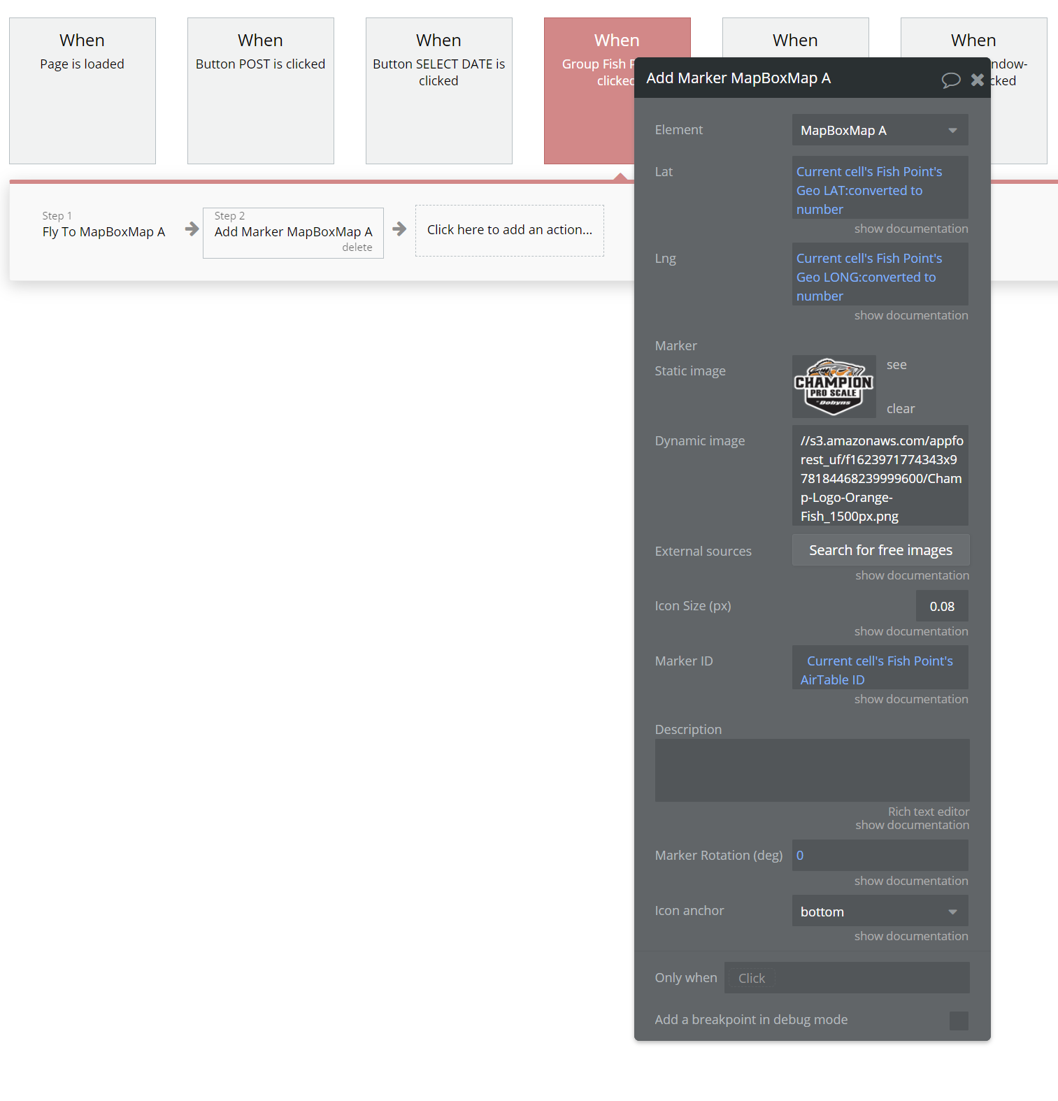

so with the markers, it is missing from the workflow action, BUT it is there on your demo page. All though the demo you have seems to be much further along in dev then this version judging by all the additional actions.
in the zerocode demos site (testing), the lat and long data is exposed below the marker source
this is how i am adding the marker ID. The ID is actually stored in BUBBLE not Airtable just FYI. That is just a fixed ID, so it is NOT using the AIRTABLE API or anything, just a plain old bubble DB text field. Once I click the ICONS though, the ID lags. You have to click it 2 times to get the ID to load and use it to reference a record for the popup.

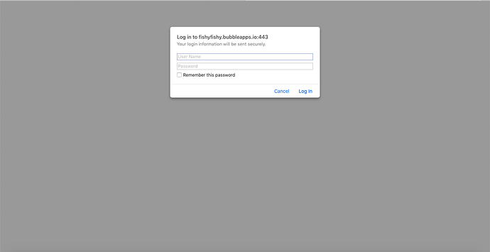

Unfortunately, despite our attempts, we cannot test your application without credentials:
We suspect that the information is not pulled from the Bubble Database, but is obtained by a third-party plugin. In order to fully check your issue, you can share your credentials to our email (support@zeroqode.com).

sent you the login. made you admin i dunno if that helps

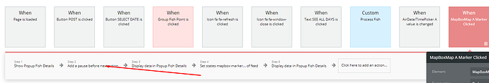

We have analyzed your issue and already fixed it.
As was mentioned earlier, you try to get information from an external source, but not your DataBase. Due to this fact, the plugin simply does not have enough time to receive this information.
For this reason, we have added the pause before actions and all is working properly.

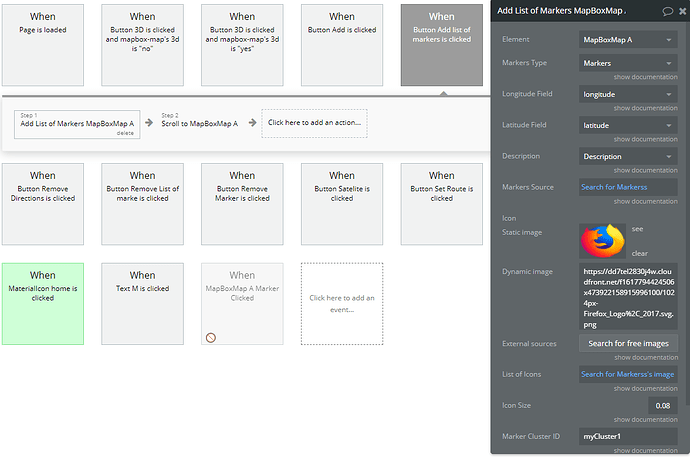

So, you need to fill in all missing information by yourself using our Demo Page as an example of correct settings.
Please find the screenshots from our page with the settings for the “Add a list of markers” action:
You can simply add the Longitude and Latitude in the workflow for this action.
Try these settings for required action and let us know about the result.

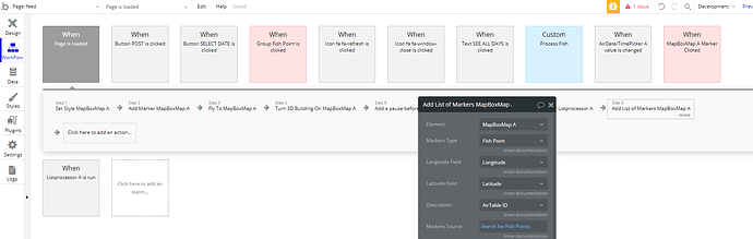

I think you are misunderstanding… the plugin DOES NOT have the actions or events shown in the demo. They are missing. Please look at the screen shots again. There is no upgrade option. It says it IS the current version. The LAT LONG boxes are missing in this version of the app, and i can not get it to pull the advertised features that are clearly on the demo site. I have tried to uninstall it and reinstall and it does not bring up the new actions and events that are just missing.
It appears that EITHER the demo is not published to the bubble plugin store correctly OR mine is stuck on an old version with no option to update to the one on the demo site.
UPDATE: I tried installing it to a new app, and same problem. Loads an old version with NO option to upgrade
MINE
YOUR DEMO SITE
As you can they boxers for lat and long are missing

After some tests, we have added the Longitude and Latitude into your database ( with the correct title and data type) and it appeared:
Allow us to recommend you to use exactly these values for the “Add a list of markers” action.
