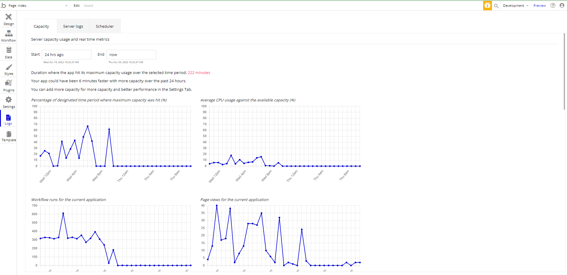

Hi everyone,
can someone please explain me how to read this information?
What does it means that I had 24 minutes of max capacity? From the second graph it seems that it never went over 10%.

This means that your application did max out for 24 minutes. When it maxes out it means that you are currently utilizing all the resources your application has access to.
The charts do not accurately display information.
Bubble doesn’t show you max utilization for a time period. Instead, they’re showing you average utilize for each “dot” on the chart. So, if you want to see how often your sever was maxed, you have to drill in to a more narrow period of time (e.g., from 7-days -> 1 hour). Even then, you can’t see when it was maxed for 10 or 20 seconds but at least it becomes less inaccurate.
The 1-hour chart will show you different things than the 7-day chart. You’d think the 1-hour chart would show a subset of the 7-day chart, but that’s not how this works. I know this is confusing and quite limiting because you can’t see the 1-hour chart for a time period a day or two ago. Welcome to Bubble.
PS - @Bubble, if you can’t fix the root problem here, can you at least change these charts to be bar charts because when you display them as line charts over time it implies the timeline is continuous? For example, in the OP’s scenario, the average would be at 100% for a few seconds and the chart should display that. Ideally, can you can simply fix that. But, if not, at least present the time period as a bar chart so it’s not actually factually wrong about what’s happening since you don’t display data on very short periods of time which the line chart implies.

But what does exactly happen when the app reaches its maximum capacity? Does it just slow down or is it as shut down?

The server will run at 100% capacity so as soon as it frees up from one task it’ll do the next.
As such, once you hit 100% capacity that means users will often have to wait longer for pages to load, data to get saved, etc. because the server isn’t immediately ready for their request but will instead put it in a queue.
Additionally, at 100% capacity, my understanding is API calls are deprioritized (and won’t run until the server is below 100% capacity again) so they often don’t run in the same order as you’re accustomed to them running relative to other workflows, which can work fine so long as your app is designed to handle this. Furthermore, I believe user’s requests can time out if it takes more than 30? seconds for your server to reply to them – but I’m not quite sure on the details here.
So, barely hitting 100% for a few seconds doesn’t really matter at all. If you have 2x more people using your app than your server can handle at 100% capacity, then it’ll be really slow for those people because tasks will queue and become really long (likely until enough people get tired of it being so slow that they drop off your site).

Hi, I appreciate your explanation.
I had the same issue with my app. I already have a professional plan, however the data loads slowly—up to 1 minute 36 secs the logs indicate that I reached my maximum storage time of 222 minutes. The software includes API calls, sophisticated processes, as well as routine backend triggers of workflows. Is there a way to manage this properly. Please share your opinion.
This is the usage log:
