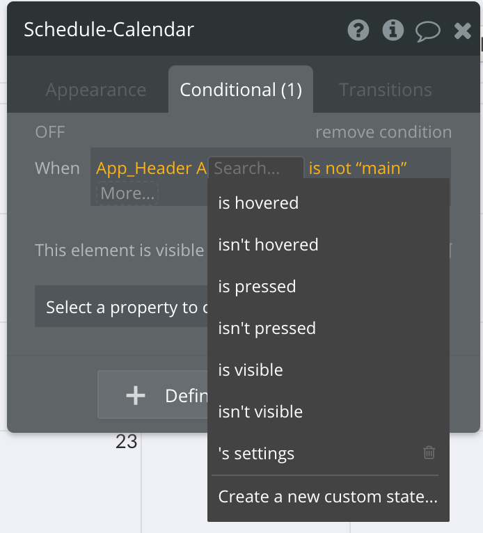

That’s really helpful! But, I think I’m a step or two ahead of you. I’ve gone ahead and done that (visible in this first screenshot)
But, when I go to one of the pages where I am using that header element, I can see the settings custom state I set up, and can interact with them. But, I can’t see the schedule custom state. Also, if I try to set up a new custom state from THAT page, it lets me go through the process but then says there’s a missing element upon clicking save or create.
Here’s a screenshot showing how it displays the settings custom state but not the schedule one. Any thoughts? Weird right… Feels like a glitch. I’ve logged out and logged back in with no luch.

Thanks for the help @luke2 I tried that as well. Clicking Create a new custom state brings up the editor and seems to let me add it, but then turns my conditional statement red and says element not found. Or missing element. Something to that effect…
