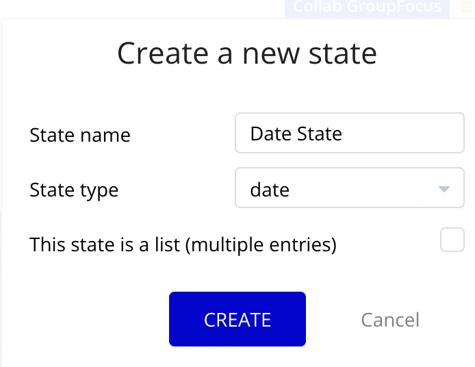

Double Click anywhere on your page. Top right there will be an information Icon. Click on that and add new custom state:

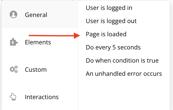

In your workflows tab, you can find different workflow triggers. Add a “When page is loaded” trigger. In that workflow, add an action that will set the date of the custom state you created.

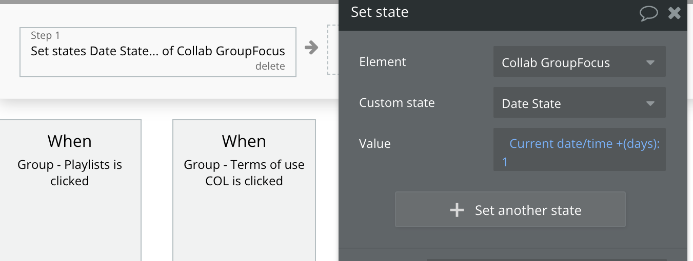

Then add 2 buttons that will set the state to a different date. One button will increase the date by 1, and the other will decrease it by 1.
The one to increase it by 1 will look like this:
The one to decrease it will be -1 instead.
