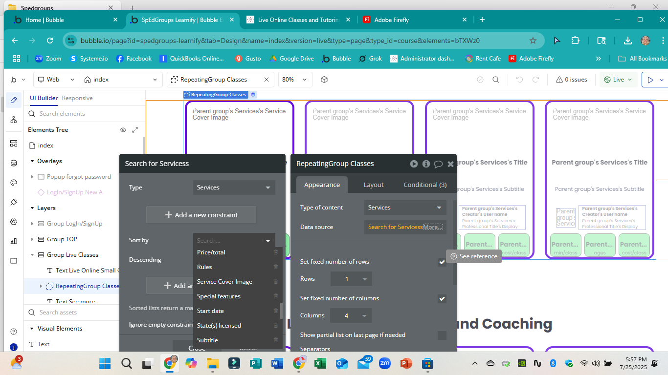

I want to do a repeating group that will show courses based on the type of service they are. I set up the data type and field with an option set, and all is working well, except when I try to put it into my repeating group “service type” is not on the list. How do I get it to appear on the list?
For one you are looking at your Live environment, switch back to Dev
Then you are trying to sort by an option set which you cant do. if you’re trying to constrain your search by a certain service type you need to click “Add a new constraint”
Also in Bubble datatypes are typically singular so you would name the datatype “Service” :hugs:

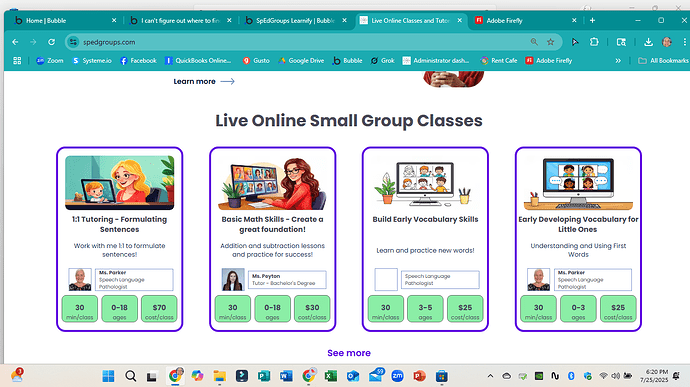

Thank you. I will try that. What I’m trying to do is to put my courses in different repeating groups depending on what service type they are. Then, I want to be able to pull all the course info I need (course title, description, price, etc.) into that repeating group also. As you can see in the screenshot. I want to have a separate repeating group like this one for each service type (live classes, tutoring, etc.).
