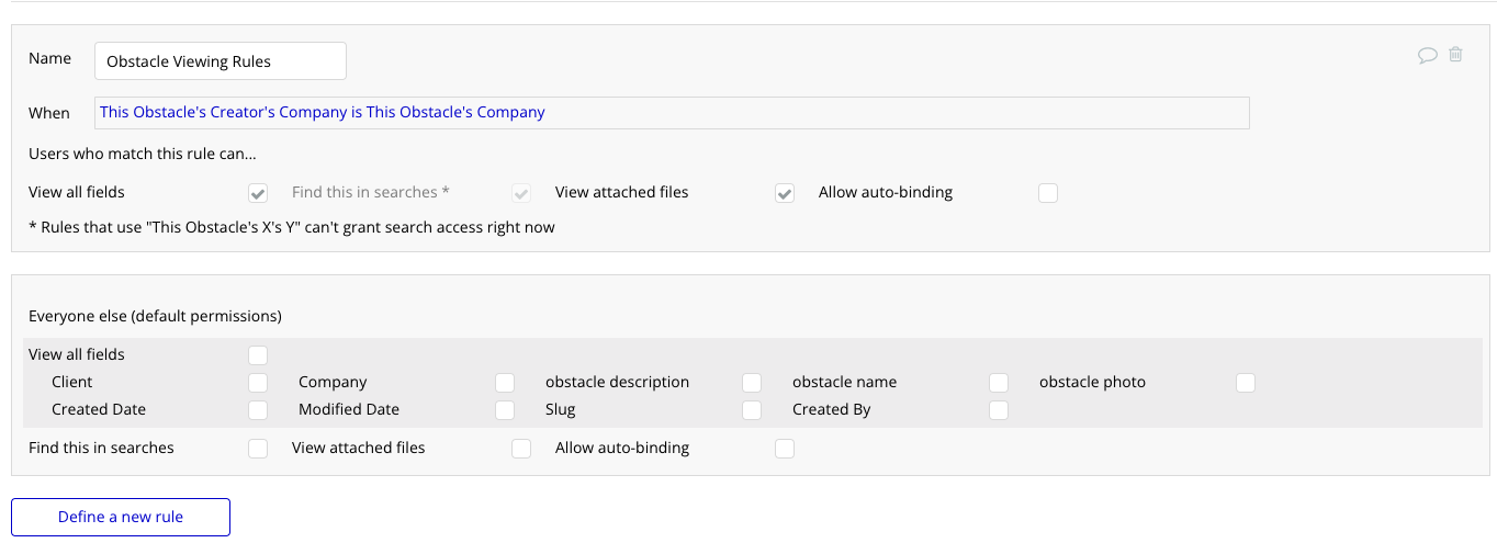

Privacy Rules for Obstacles:

And that privacy rule is no good either (the message is telling you that you can’t get search access using that).
Privacy rules can only go one nested data level deep for search access.

As far as privacy rules go, I have turned them off for now to make sure I set this up correctly, and will aproach privacy rules later with the goal of making only users of the same company to be able to view company associated clients.
