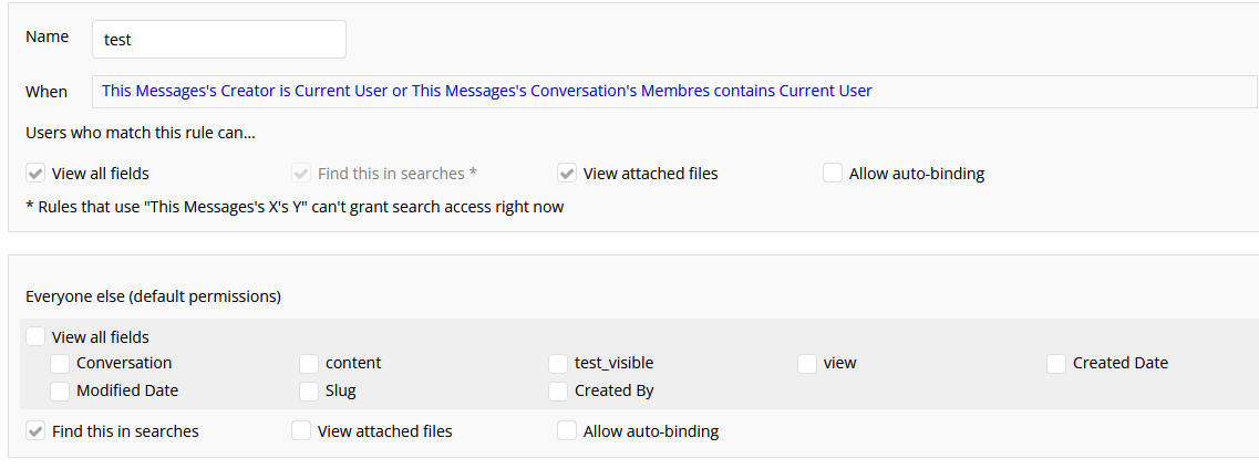

Hey @J805 , thx for the reply, that’s what I’ve put in place :
and that’s why I don’t have my message list.
But how do I set the privacy rules correctly ?

It’s a privacy rule problem, when I delete the privacy rule I get my messages displayed.
Before :
i set it like that now :
I created test_visble :
I created test_visible , it’s the list of people in the conversation that can read the msg.
Now it works, but I still duplicate the data in the database between test_visble and the Members conversation table.
conversations table :
do you have any other solutions please?

Yes, it works, but it means that I have twice the list of conversation users in the database:
  • in the conversation table (Members = list of users)
  • in the messages table (test_visible = list of users)
    I don’t find this very optimized , It also works if I put this privacy rule :
    is this a good rule ?
Hey @honkaiimpact3teste :waving_hand:
I think you are close, but this is not really a good setup, see the error here:
It is sometimes best to duplicate data for the sake of privacy rules.
For example. If you were to have each company have their own private data on an app, each database thing would have to have the parent company attached to it to keep it private and to match up the correct data with the correct company.
Does that make sense? For your app, each message could have the list of users that can see that message for privacy rules to work properly. :blush: Hope that helps a bit.
Hey @J805 ;
Okay thanks for the explanation i’ll go back to adding a ‘visible’ column with the list of users who can see the msg.
