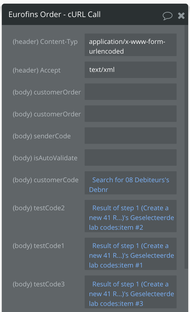

Note that “Private” must be empty to be able to fill with dynamic data
if you have done that it will appear in the workflow of your page:
than you can enter dynamic data:
