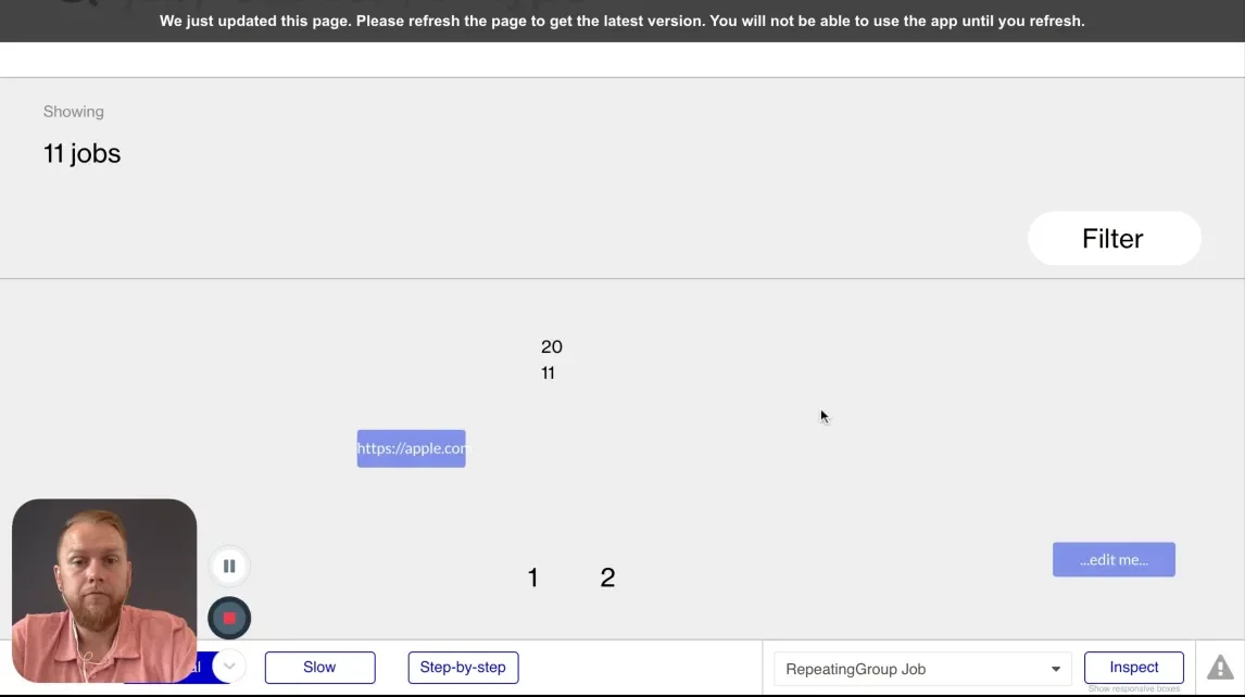

I’m trying to collapse a “fixed number of cells” repeating group when search results are lower than the fixed number. The reason I have the layout style set to fixed is because I have added a pagination feature and it will not work without that layout style set.
The issue: When search results are lower than 10, there is a large space between the repeating group and the pagination toggle. I’m trying to figure out how to collapse the extra space dynamically - depending on how many search results are show.
I’ve attached 2 zoomed out screenshots to explain the issue. Not sure how to fix this, can someone help me solve this?

Here is a image of the RG:
As you can see, it’s currently set to fixed number of cells. I have also added a pagination feature at the bottom (which used the toolbox plugin “List of Numbers”). The pagination functionality works as expected - If I were to go to the second page I would see 1 listing, however, the space between the RG and pagination feature is extremely large.

WHOA! Cool fix here worked out by mme and @brandon6
So what we did was .
give 1 single RG a few states
allThings
thingsToShow
currentIndex
we also add 2 hidden inputs on the screen to create the required pagination indexes
they are set up like this to capture 1-10, 11-20, etc
Screen Shot 2021-07-23 at 3.10.46 PM
Screen Shot 2021-07-23 at 3.11.21 PM
we set up the RG to only show between start and end and used full list and only designed/showed 1 cell in the editor.
Screen Shot 2021-07-23 at 3.12.13 PM
then its just a matter of moving through the index
on button click, the index is either raised or lowered by 1
the entire screen is short but fully expands with the list, the list that caps at 10!
