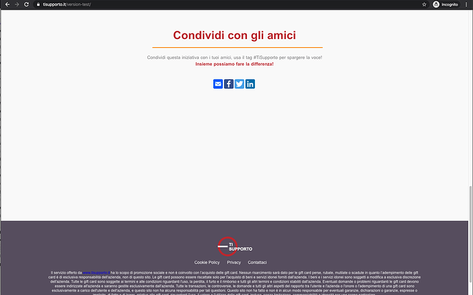

I have been on this problem for the whole day and I didn’t find how to fix it. Can you please help me?
Basically there is a white space that appears between the last group of the page and the footer. This space only appears on desktop and only when the page is stretched more than 1200 px (the width which I used in the setup of the page).
Do you have ideas how i can solve this?
You can view the page on https://tisupporto.it/version-test/
Thank you very much for the help!
Alex

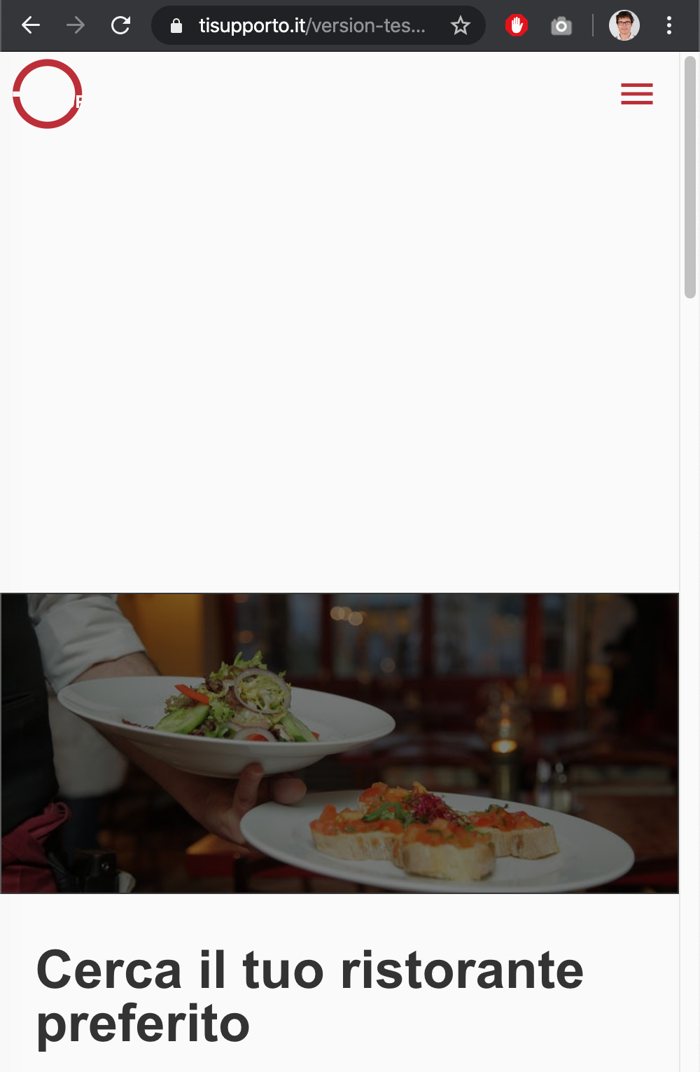

In the meantime I played around and I changed the structure of the screen by removing the Group Main Container, which was the parent of all the groups which build the different sections of the screen. By doing this I solved the issue at the bottom of the screen. Nevertheless, the problem now is that on mobile, the Group Main Desktop does not collapse. This was exactly the reason why I created a parent group containing all the other groups, to solve the issue in mobile.
Can this issue be related to the issue we had before? Any suggestion?
You can see the issue in the screenshot.

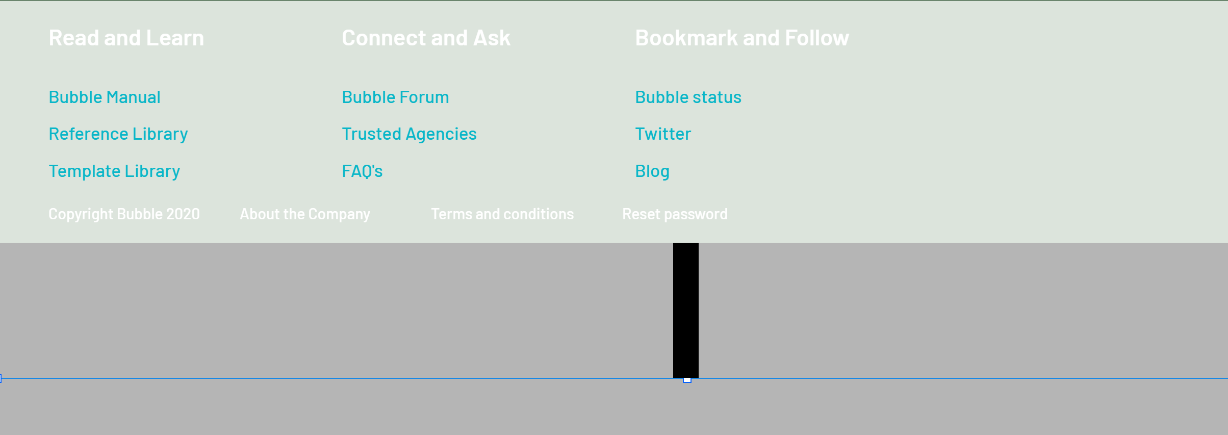

I’m having a similar issue with a large white space below my footer. I have investigated everything I can think of and I cannot figure out how to make it go away. I’m close to contacting bubble support because I don’t think it’s anything I’m doing.

I ended up just getting rid of the “group within a group” section and it solved my problem. Not ideal though if it’s a requirement to keep a particular group hidden and it’s jacking up the bottom of the page. Hopefully they deploy a fix soon.
Hi Alex,
I just found a fix for this problem, if you still need it all these months later haha.
On my page, my footer is a reusable element. If you go into the reusable element and great a Group beneath it that is NOT visible on page load, and collapses when not visible, this will solve it. If your footer is not a reusable element, you will need to do the same thing on the actual page: put the “false” Group under it to the bottom of the page, and apply those settings.
