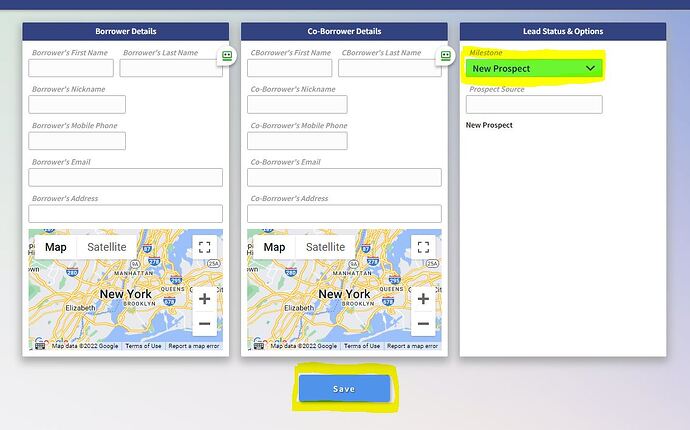

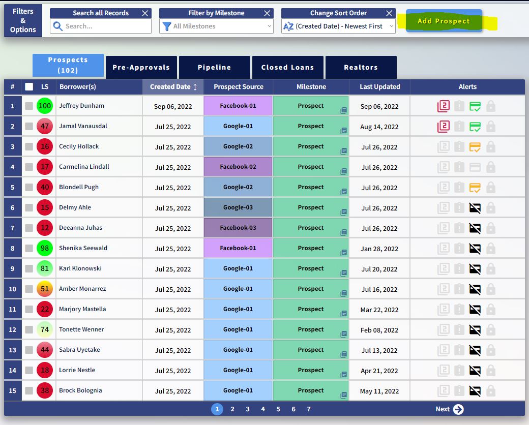

This first image is of the main CRM screen. When I want to add a new item (PROSPECT), I have the Add Prospect button which opens up a popup.
This popup opens and the data type is PROSPECT. I have a reusable element that contains the Milestone dropdown. When the dropdown is selected, it creates a Custom State with the milestone name.

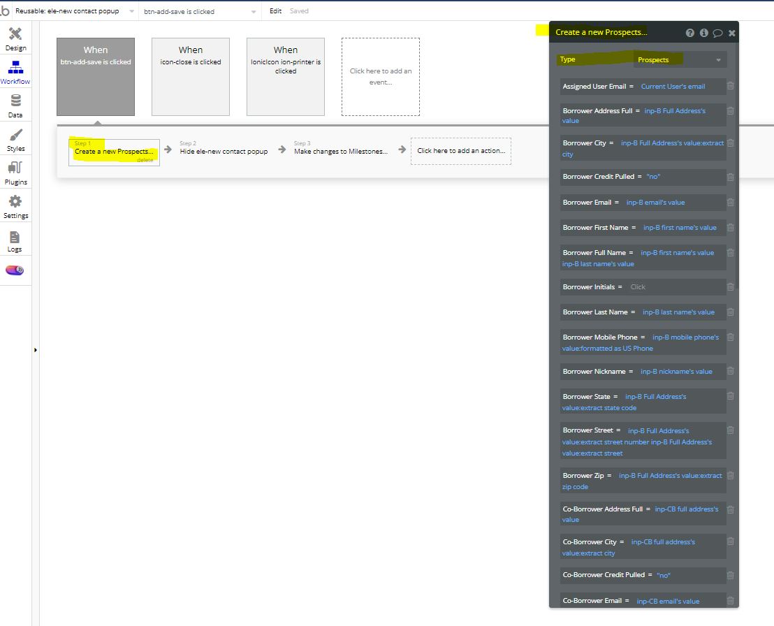

When the information in this popup is filled out, I have a Save button to initiate the workflow. Step 1 of the workflow saves all the PROSPECT data. That works as intended.
Here is where I get stuck. In the 3rd step of the Workflow, I am trying to save the milestone selected to PROSPECT>MILESTONES>milestone. In other words, while the MILESTONE is a separate data type, it is linked to the PROSPECT data type.

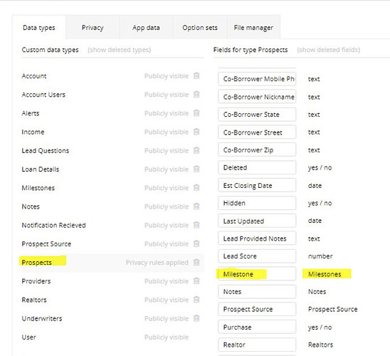

Here is the data type structure. You can see how the Milestone field links to the MILESTONE data type from within the PROSPECTS data type.
Here is the MILESTONES data type. There is a field called Milestone that I am trying to update and have that linked back to the PROSPECT. While all my instructions seem correct (i.e. at least not generating an error), there is obviously something I am missing.

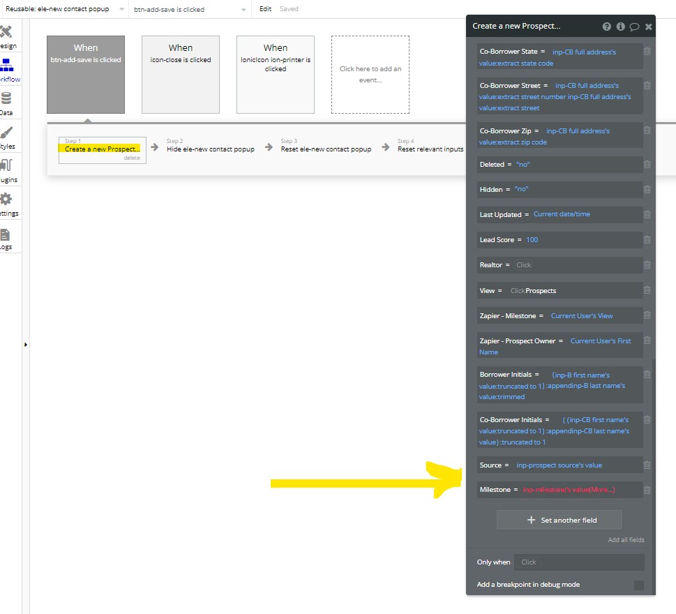

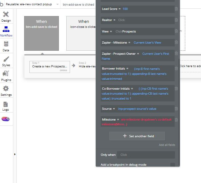

Here is what I get when I try to do this in Step 1…
You already have a field of type “Milestones” on your Prospect. The field is named “Milestone”. (Also, yes, your naming convention is a bit wacky having named your Things in the plural. This is a common mistake so don’t feel bad.) However, I don’t quite understand your confusion.

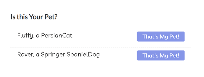

Here’s another view of all the Pets. This time in a repeating group in some page:
Now a User comes along and say, “Oh hai, Fluffy is my pet!” and they click the button. Let’s put the Pet for Fluffy on the Current User:

I thought that was what I was trying to do. For an example, when the milestone input field is set to ‘Contacted’ by the user, I am trying to save this under the Prospect’s Milestone field.
But that’s the problem. It won’t let me save it. In your example, you are saving Current cell’s Pet to the Pet field under user. In my case, I am trying to save the Milestone Input (text) to the Milestone field under Prospect. It just won’t let me.
Here is the screenshot of the workflow showing the error:
It doesn’t allow me to save the Input’s Value to the Milestone Field under Prospect. Maybe I am still confused, but isn’t this what you were doing in your Pet example?

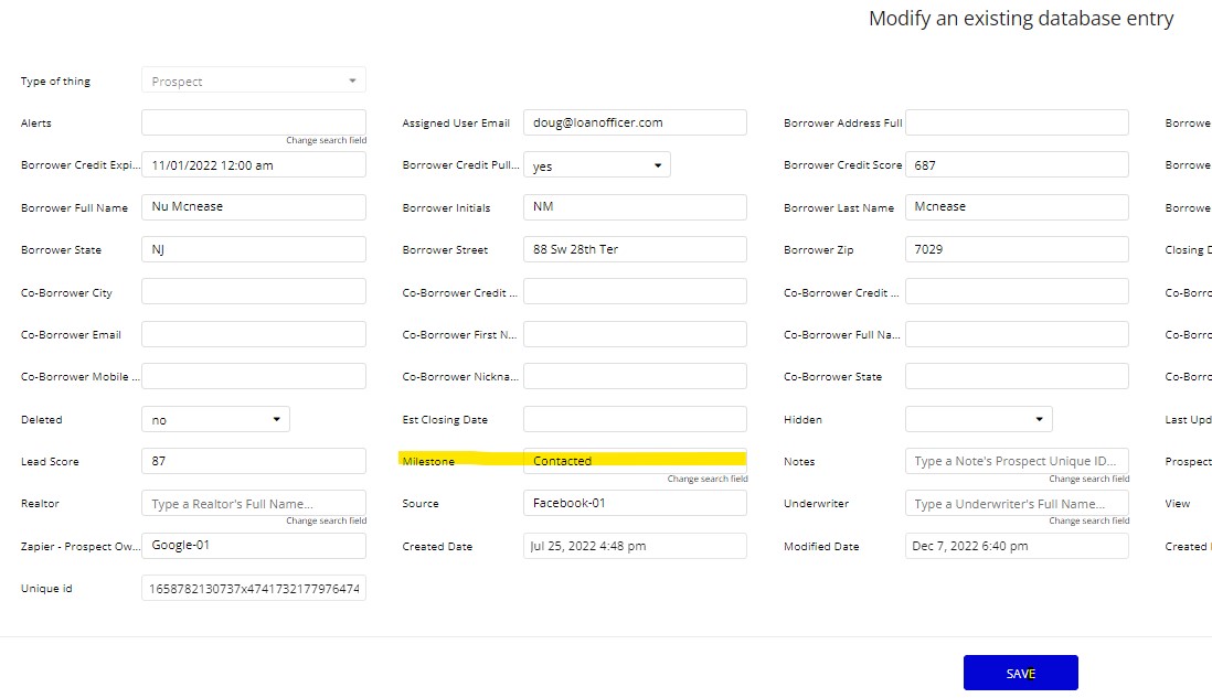

If I go into the App Data section and manually assign the Milestone, it works as expected:
Do you see what I am doing wrong?

I’m going to assume here for a moment that a Milestone is some admin-created object. Like, you have defined a set of Milestones that represent things like “Got Her Number”, “Called Her and Asked Her Out”, “Went on Date”, “Didn’t Get Past First Base”.
If so, you wouldn’t use a free text input to get those, you’d use a Dropdown (or perhaps a Searchbox), right? Because that will return to you the Milestone itself (like a Pet) not a string that’s the name of the Milestone.
In your case where you have a text input, that input’s value is just a text (a string). It’s not a Milestone.
If you Milestones have unique Names (for example), to get the Milestone named with the string “Contacted”, that expression is:
Do a Search for Milestones [constraint Name = that_text_input's value]: first item
:point_up:"find the Milestone in my database whose name is “Contacted”
NOW, if instead, Milestones are just an object with some arbitrary name and those names don’t have to be unique (that is, the User can just create a Milestone and give it any damn name they want), then what you are looking to do is:
Step 1: Create a New Milestone (and set its name to the value of that text input)
Step 2: Create a New Prospect (set all of your fields to whatever - you set the value for the Milestone field to be Result of Step 1: Create a New Milestone)

I technically created a custom dropdown made of inputs and buttons, but I assume this would be viewed the same as text input. I will try just using a regular dropdown to see if that fixes it.
I’ll report back later.
So that was it! I added in the dynamic dropdown box, constrained the search to show the correct options, and then saved that value to the prospect. Everything worked exactly how I was expecting all along once I used the default dropbox.
I was never aware that you couldn’t save a input or custom state as a text and not have it recognize that the string matches with the linked database field. Do you think that is the intended action, a limitation bubble, or is that how it is supposed to work?
