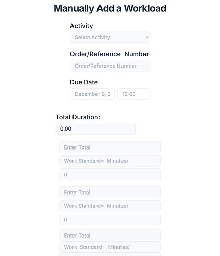

Here is a shot of the Pop up once loaded:
I’ve then selected the activity from the drop down “Picking Cart”:
I then entered the values (1,2,3) for in the inputs as shown below. The input below Total duration should now be populated with the sum total:

Fixed it!!
I had to add the expression to the initial content on the inputs highlighted in yellow below.
The input circled in green is the correct total I was trying to achieve.
