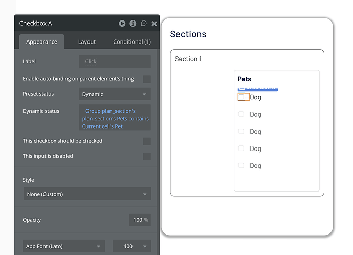

Thank you @adamhholmes. I tried setting it up this way too, but I still can’t seem to be able to access anything from the parent group. Do you see anything here that I’m getting wrong? In that final checkbox, I want to be able to base the dynamic status on whether that Pet is in the parent Section.
You should just be able to refer to Group plan_section’s plan_selectoin.
A checkbox expects a yes / no which means you can’t reference the data type, only a yes / no value.

That’s where I’m running into the problem. My nested RG is the owner’s complete list of Pets, but when I’m creating the dynamic expression on the checkbox, how do I reference the associated session’s data? My checkbox dynamic expression is only allowing me to see the Current Cell’s thing which is a pet. I can’t select anything from the Parent RG (Session) on the checkbox element that is in the Child RG (All Pets on User).
As I showed above, you just need to refer to whatever group it is, inside your parent RG, that contains the session data.
e.g.
I don’t have the “is in” available after I select Current cell’s Pet, only “is” or “is not” are the only operators available. Under “other operators” there are options regarding empty status and the slug, but I have nothing for “is in.”
