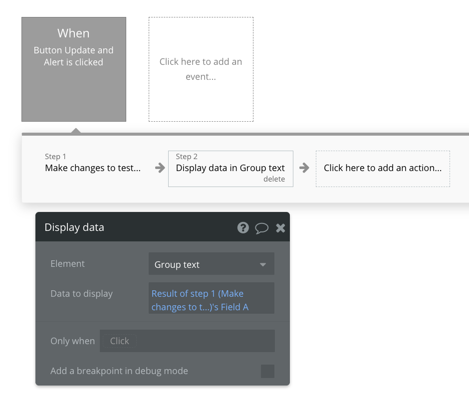

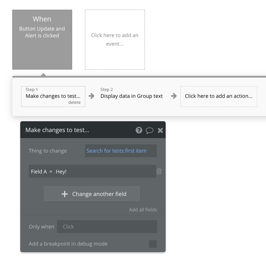

  • Step 1: Make changes to a Thing, where the Thing to update is a search for that Thing. You are updating Field A to ‘Hey!’
  • Step 2: Display data in a Text Group that contains the Result of Step 1’s Field A.
If the search for things returns an actual thing in your database to update, then everything works as it did previously: “Result of Step 1” did and will still contain the thing which you created or updated, which therefore have all its fields, including the updated Field A, and therefore Step 2 will set Group data to text ‘Hey!’
If the search for things returned nothing, you will not be updating anything: Step 1 is basically a no-op.
The results of Step 1 do not contain an actual thing in your database, so all its fields should be empty.

In particular Field A will henceforth be also empty, because nothing was updated, and there are no results to step 1. Step 2 will set Group data to no text, because “Result of Step 1’s Field A” is empty.
Old behavior:
Result of Step 1 would contain an extremely barebones ghost Thing, with no id nor any field, EXCEPT for the changed fields, which were inferred to have successfully been updated. Result of Step 1’s Field A would therefore be ‘Hey!’ and the Group Data in Step 2 would be set to text ‘Hey!’.

  • If you make changes to a Thing that exists, but change no field, results of that step always have and still contain that Thing.
  • If you make changes to nothing (a Thing that does not exist) and change one or more fields, the results of that step used to be “mostly nothing” but with ghost updated fields, and will now be “definitely nothing”.
As for the ‘ghost’ behavior I alluded to, that is the following:
setup (using the setup from my example):
  • You have a Thing table with no entries at all, and Thing has a Field A of type text.
  • You have a ‘Make changes to a thing’ action, that does a search for the first item in the empty Thing table (or any search that does not return a thing)
  • This search sets Field A to ‘hey’
In following steps, let’s look at some expressions for Result of Step 1:
Result of Step 1 is empty -> yes
Result of Step 1’s unique id -> (empty)
Result of Step 1’s unique id is empty -> yes
Result of Step 1’s Created Date -> (empty)
… this would also be the case for fields not mentioned in the previous case (everything would be empty)
now before version 9,
Result of Step 1’s Field A -> ‘Hey’
Result of Step 1’s Field A is empty -> no
After version 9,
Result of Step 1’s Field A -> (empty)
Result of Step 1’s Field A is empty -> yes
This is a lot more consistent with what actually was changed, because in essence we don’t want to have any partial Thing exist in limbo during your workflow run like this: the resulting Thing would essentially be something without a unique id, no fields whatsoever, except for a few fields that would have inherited the values from previous steps, which is why I refer to it as a ghost thing. It would also not match anything in the database, so it is safer to make sure that it does not contain any fields.
I hope this clarifies the updated behavior for everyone!
