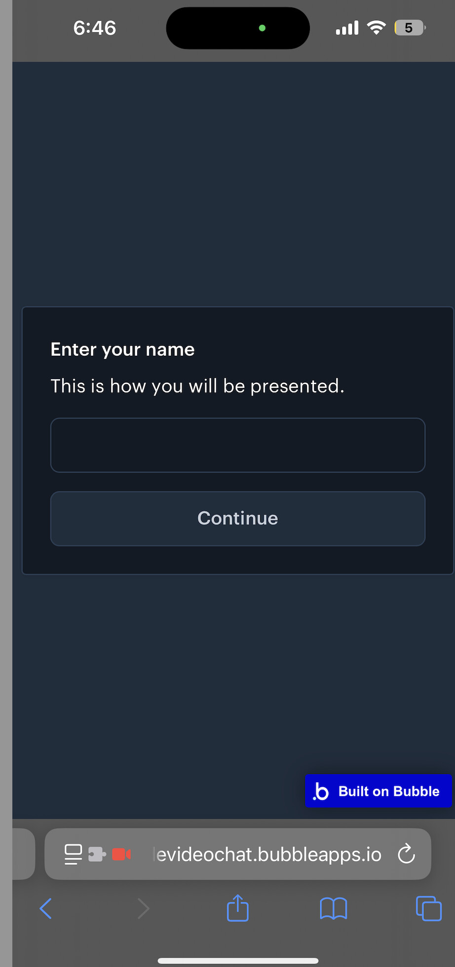

Hi @lola ! I was just testing the meeting room link to join via mobile and it has popup to unblock mic and camera…on step 1 - I cant find anywhere in the browser bar camera icon to be UNBLOCKED (NB. the camera looking icon at top is google lens).
Do you have a more concise step by step how to unblock this - as I am planning to use daily plugin for virtual consultation platform and can imagine most users will want to join the call via their phone ?
Thanks for reaching out, @ellustro!
What browser are you joining from?
It depends on your browser, but typically you can update permissions from the top corner if you initially rejected them when the call started.
Here’s what it looks like in Chrome:
On Safari mobile, the settings are at the bottom, for example.
Just a heads-up: if you’re building a native mobile app with Bubble (not a web app), this particular plugin won’t work, as Daily prebuilt is built for the web. You would need to wrap the app to be able to use in a native mobile app.;
