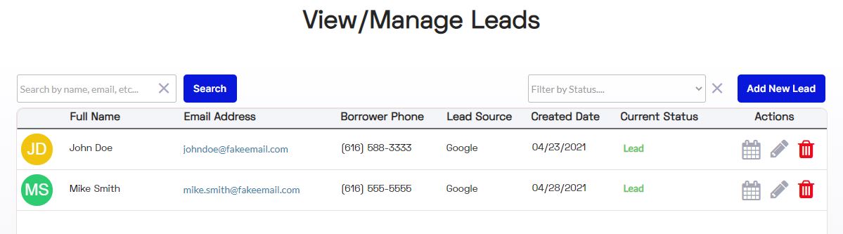

Here is the page showing 2 example LEAD’s:

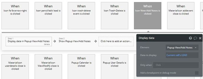

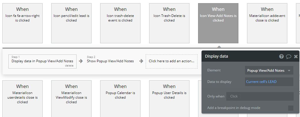

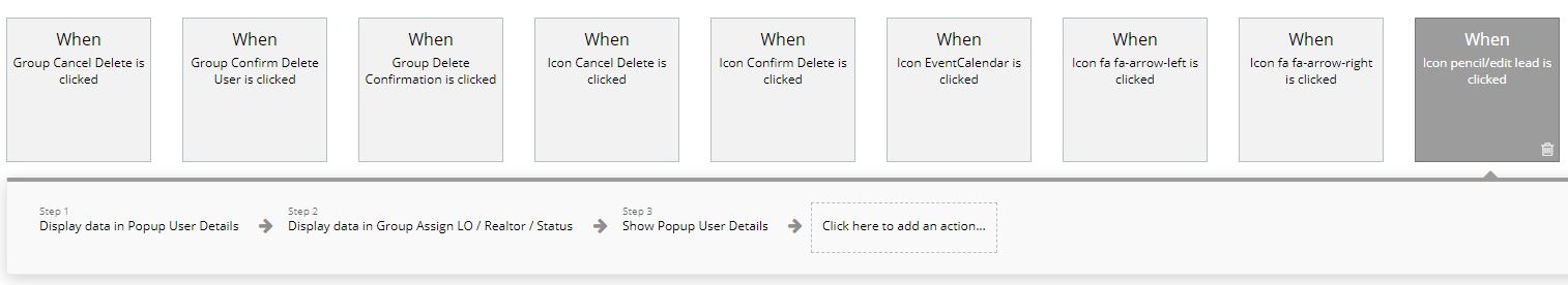

Here is the workflow when someone clicks on the leads Pencil/Edit icon. It brings up a popup (popup user details) with all the lead details:

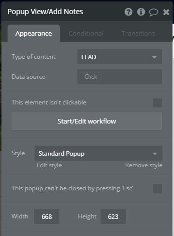

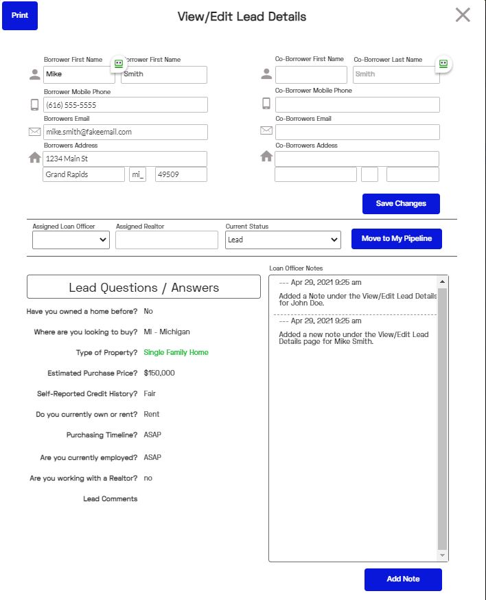

Here is the page showing the Popup User Details. Note how I added a couple of notes to the lead. Even though I add the note to the specific lead, the notes show up on all leads.

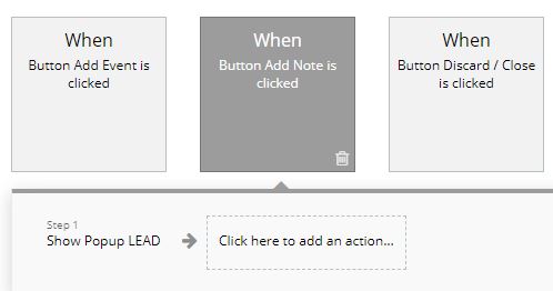

Here is the workflow that saves the note:

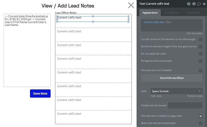

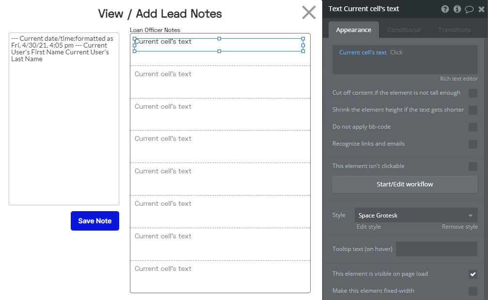

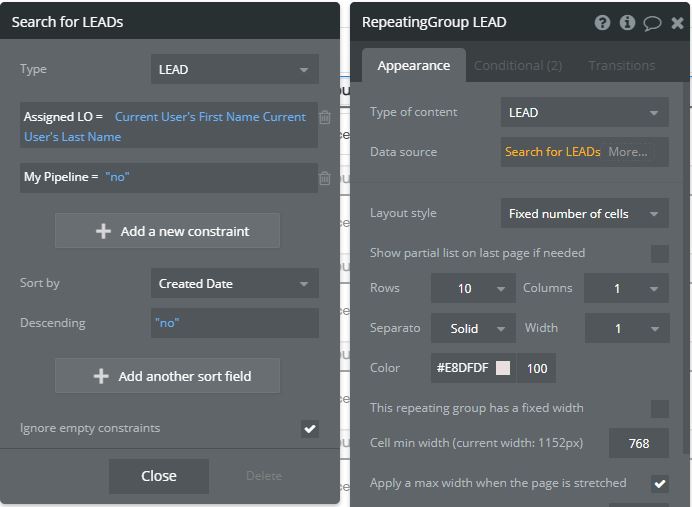

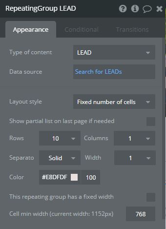

Once the note has been saved, here is the RG and nested RG and text that displays the notes on the lead detail page:
