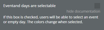

Notice that after I update the plugin to version 2.122.0 (or above) the option to block the user from select dates and periods stop working
Hi @rpetribu,
Thank you for reaching out!
To ensure everything works as expected, please update the plugin to the latest version (2.127.0) and test the selection block feature again.
You can also try it on our Test Page where the selection is turned off to see if the issue persists.
If the issue continues, please share any additional details about your setup, and we’ll gladly assist further.

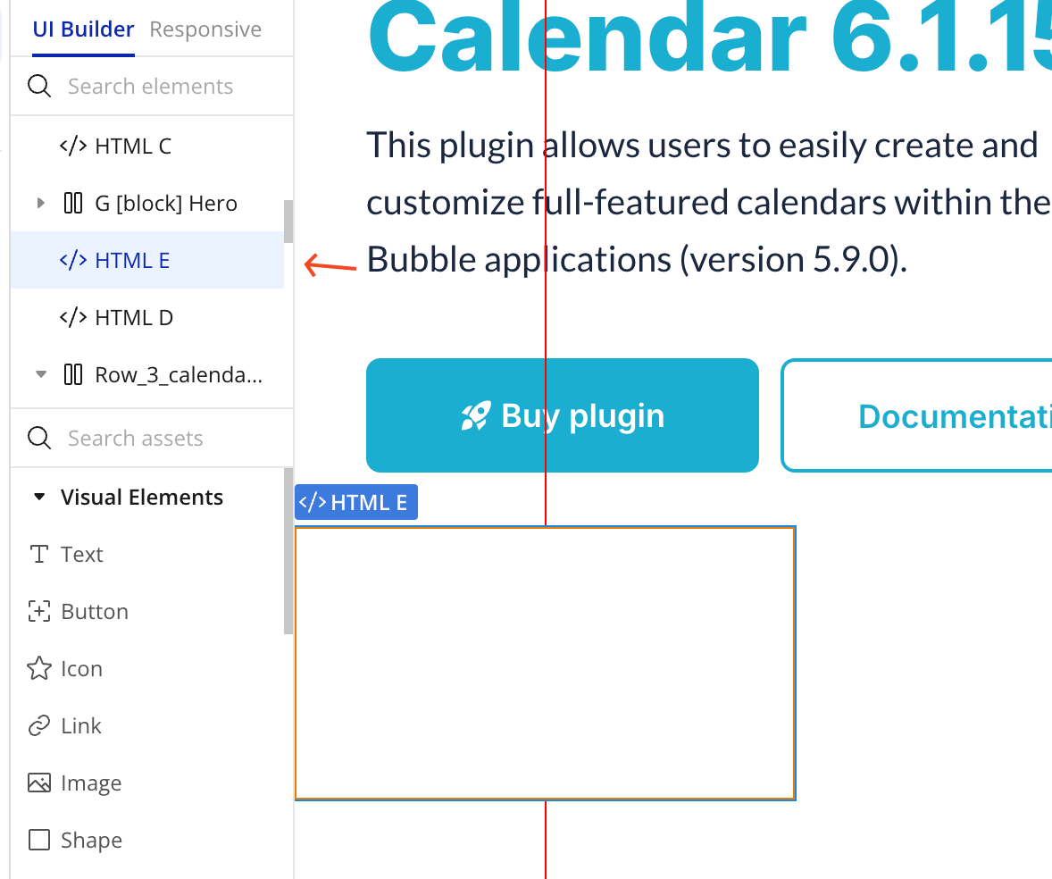

Hey @hari.pai1296 ,
Thanks for reaching out and providing the details of your setup!
It seems that many of the issues you’re facing are due to limitations within the plugin’s library when working with custom views. Specifically, certain values are assigned to other views instead of custom views, which is causing some of the behaviors you’re seeing (like time slot visibility and other format issues).
However, to assist further, I’ve gone ahead and created a test page with HTML elements and CSS inside. I was able to make some adjustments, and you can check it out here:
Test Page
Look for HTML element E on the page for the changes I applied.
I will also inform our dev team about this limitation and ask them to look into possible updates to the library that could help resolve these issues in the future.
