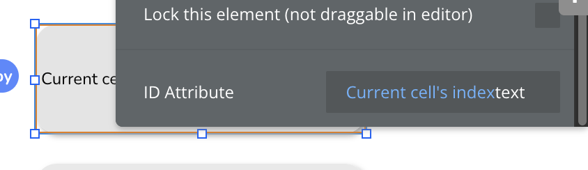

Hello @kaya
Thank you for reaching out.
The setup seems to be correct, but there are some things that we would like you to check and change. Please do the following:
  1. For the Trigger element ID and ID Attribute, please change so that the “Current cell’s index” is placed before the word “copy”. Just like it is illustrated in the attached screenshots.
    Screenshot 2022-06-21 at 14.53.45
  2. Please make sure that the target element ID is actually "text" and not a group, as it is in your case right now.
Please do check and change the mentioned things and let us know the result :slight_smile:
Regards,
Zeroqode Support Team
Thank you! It worked!
